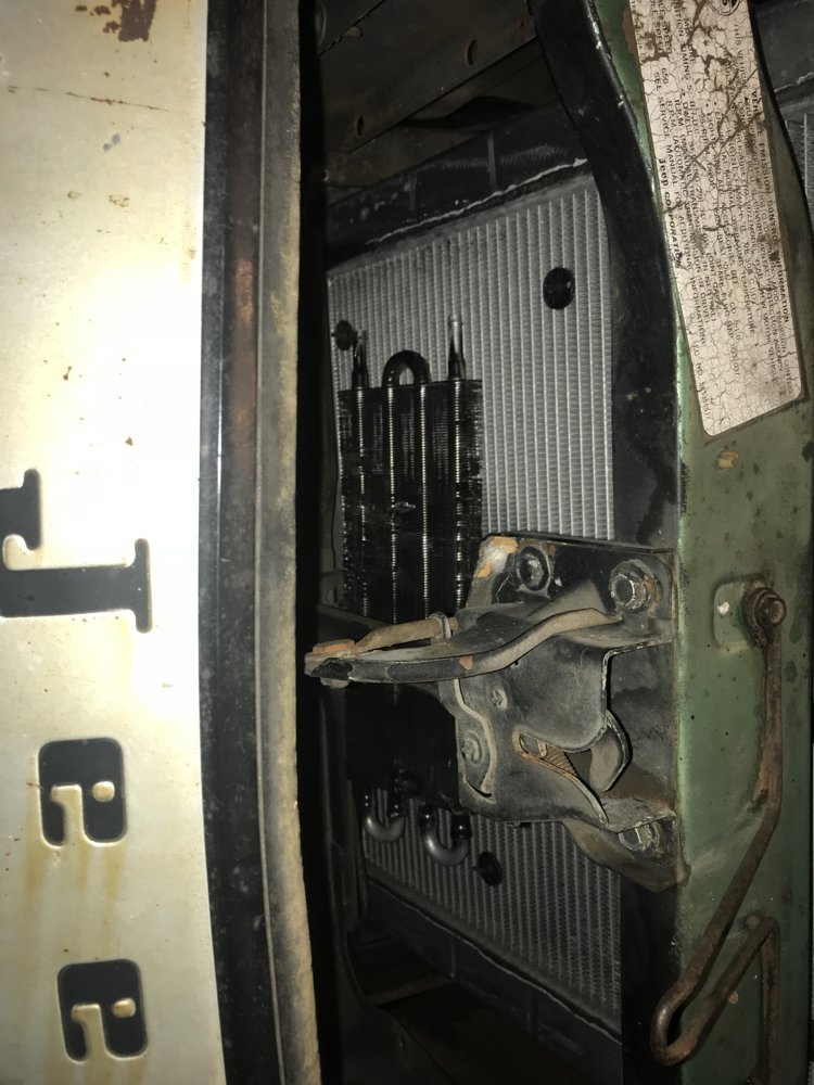

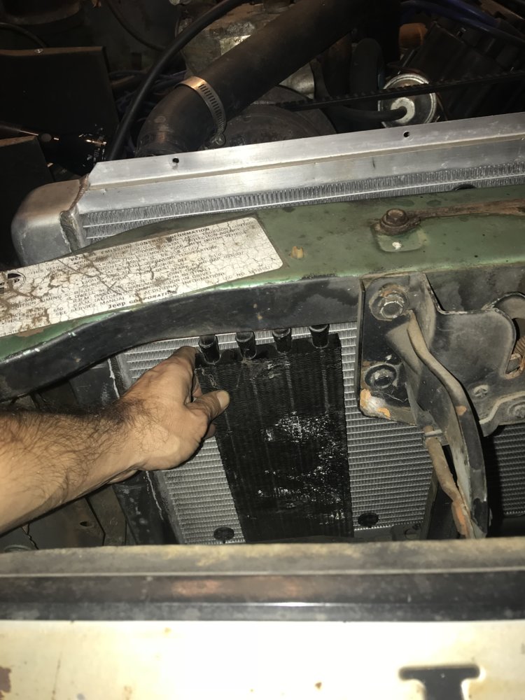

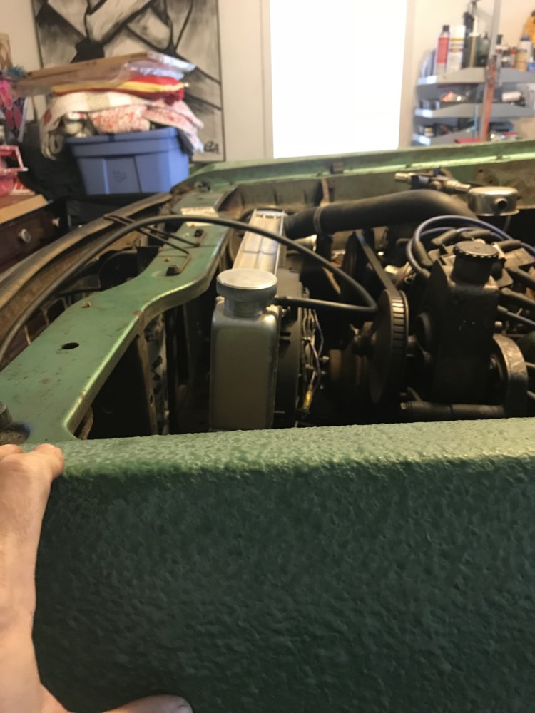

I’m installing a new aftermarket radiator in the Commando. The OE one has a built in trans cooler into the lower tank. So I need to install a separate cooler. Does it really matter or alter efficiency if it’s mounted vertically or horizontally? Can’t say I’ve ever seen or noticed a vertically mounted one.

No good input here but I was pondering the same thing on my 79 the trans cooler wasn’t hooked up bc newer model rad had cooler in it but the one I’m swapping doesn’t so I’m using old cooler but want it vertica for clearance, From what I’ve read it will be a issue says one person, and the next guy says no effect at all...? Lol
It won't matter and FWIW, I like to run both. The one in the radiator is a heat exchanger and helps bring the fluid up to temp. Run through that first, then the external cooler, and then back to the transmission.
If you mount it horizontally, put the inlet on the bottom and return up top. Vertically, it won't matter which is which because it's a multiple pass tube/fin. If it were a plate/fin cooler, I'd say have the fittings at the top so the cooler would stay full and work more efficiently.
