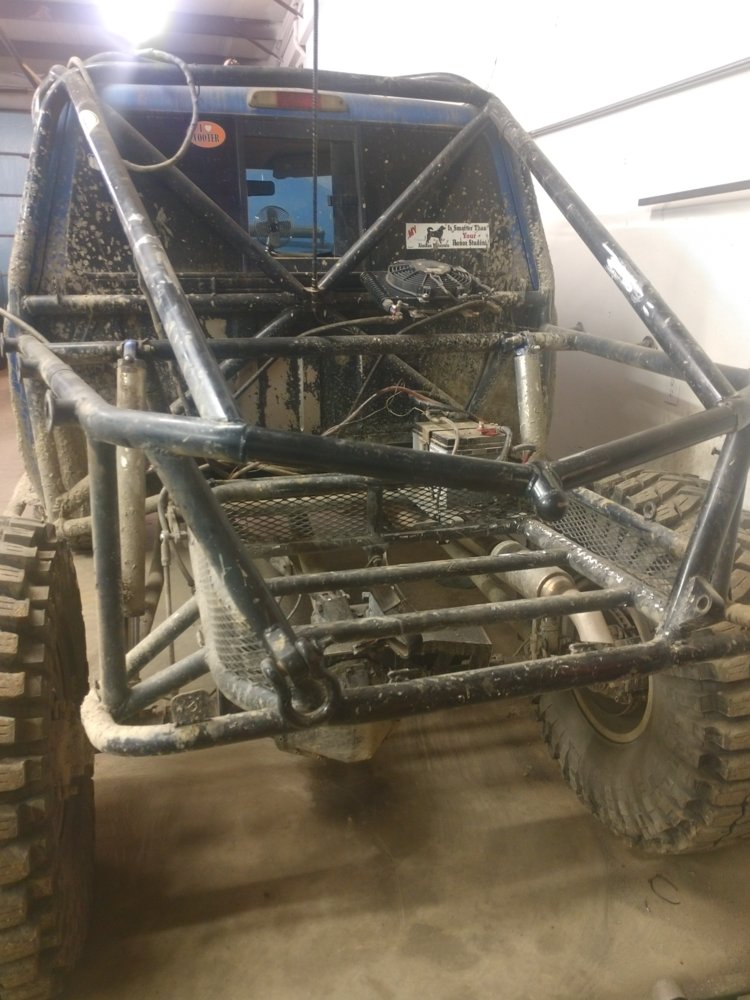

I'm running a fan as my cooler is remote mounted in the bed area of my truck.
I needed to get it away from the heat under hood
See here:
