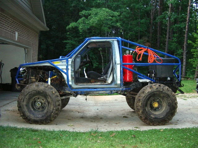

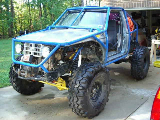

Here is mine:

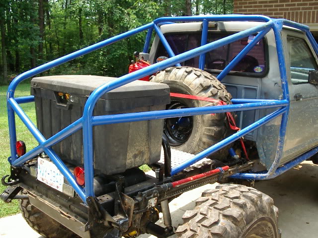

Is the cage welded to the frame or bolted... Only ask b/c you took it off.
It is welded. It was just tack welded on to the frame at first, then removed to weld the underside.
