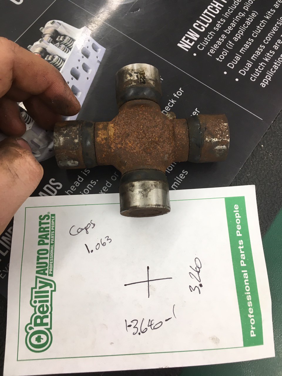

This was in a zj stock rear axle, but a 242 transfer case was swapped in possibly a different drive shaft.
Here is a picture of joint and measurements
That looks like a 1310-1330 conversion joint to me. I'm not a home where I have my catalog so I can't get you a number but if you can get them to pull a paper catalog at the store you should find it easy.
Sent from my E6910 using Tapatalk
Exactly, 5-134x
1310 to 1330
I asked Dave Whitley at Oliver's. Drive line.
I'll post if he says he has one in stock.
@Loganwayne. Oliver's has them in stock.
Probably Spicer. Maybe some others.
