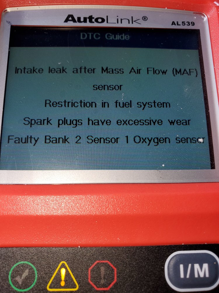

I got this off a obd II...

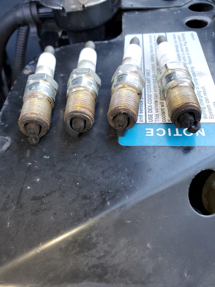

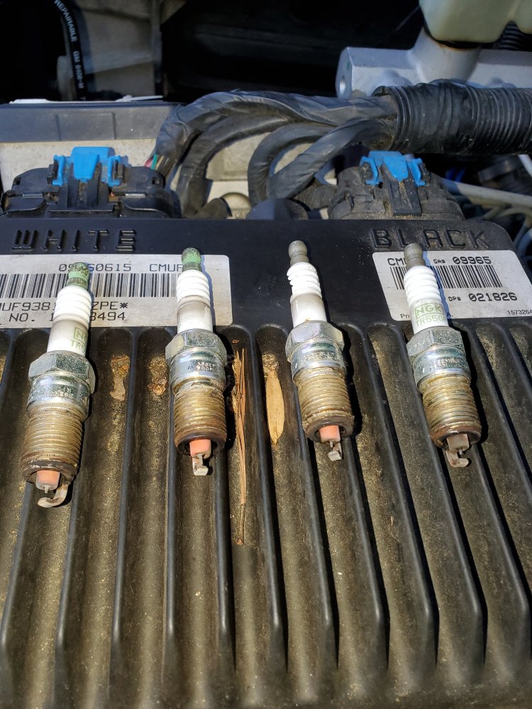

And found this today.the passenger side....
And the drivers side...
Holy gawd damn gap, dude.....unless that's the camera playing tricks. What were those plugs gapped to?
I wouldn't sweat the coolant tank yet. Are you talking about the reservoir? If it were burning coolant in the chambers, you can usually smell that. Smells kinda sweet. But it is weird that the plugs from one bank vs the other are completely different looking.
