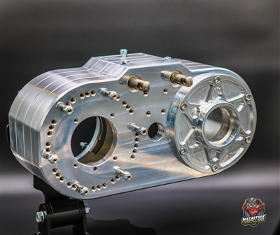

The lomax setup would most likely be your shortest option, which is the opposite of one of your requests. And as Jody pointed out, they're expensive. With the availability of 231/241 underdrives now, I'd be hard pressed to pick another option.
Duane
They are not designed to fit in an OEM case also. JB Conversions sells a custom case and so does behemoth or whatever their name is these days.
They fit the GM 205 case but not the Ford version unless something changed.

Actually no. JB Conversions, Inc.
FAQ
Q: Can I use your gears in a stock case?
A: No, our gears only work in custom cases. They do not fit stock cases.
Q: Can I modify or machine a stock case to fit your gears?
Q: Do you sell a custom case?
A: Yes, we sell a build-it-yourself gear and case kit or a completely built unit.
Q: What side front output is available?
A: The JB Conversions custom case is passenger side front output only.
Q: Are other custom cases available and what outputs do they offer?
A: Custom Billet cases are available from Behemoth Drivetrain. They offer both passenger and driver side front outputs.

Dang. They really cut a portion of the market with that move. But now they can sell their own case, so there's that I guess.
IR DUM
From what I remember it has always been that way. Hence why you can only do passenger drop. At one time they were saying they were going to do a Ford but it has never happened.
