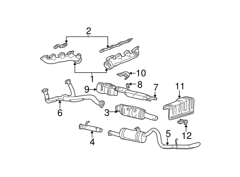

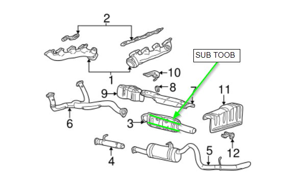

Should have 3 cats. I’d bet one of the uppers came apart and clogged the secondary. The real cats are up by the manifold between the sensors. They are prone to leak under the intake and burn off. I’ve worked on 6.8 buses for a while. The pipe under there will leak. Have even seen a few heads get a pinhole I’m assuming to bad casting. If you cant verify the leak put some dye in the coolant.
My arrangement looks more like this picture. I will crawl back under it and take a look again. I did drop the large CAT. Replaced with through pipe. Surprised it isn't terribly louder. Didn't appear real sooted upšŸ˜•. Not much if any change in power.

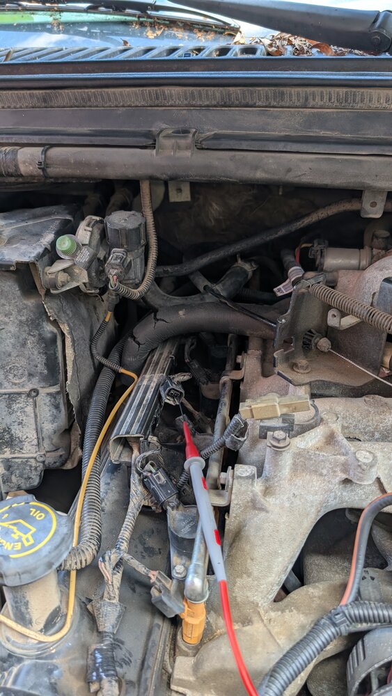

So update.
Codes read every coil on the passenger bank dead. Also a fault code for the PCM itself.
Using inferred the manifold on that side never warms up.
Explains the red hot converter. Fuel not being used in 5 cylinders.
Each coil has 12 volts positive non interupted.
None on the passenger bank has a ground signal.
Leaning toward PCM.

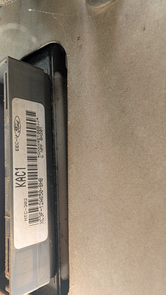

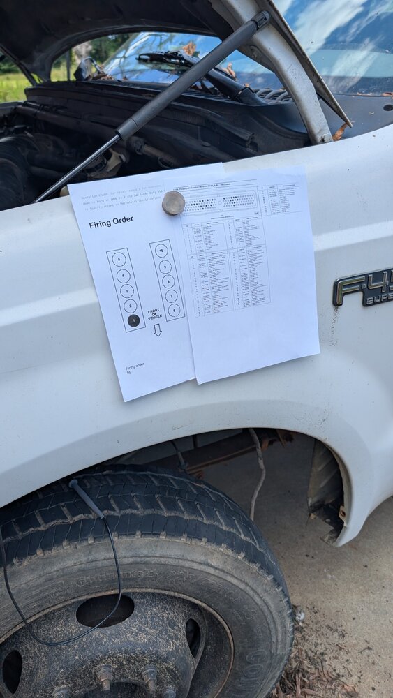

Does anyone have access to a wiring diagram and pin locations for the ground signal at the PCM? I want to individually ohm and those coil circuits. VIN and build date next pic for reference.
Found some diagrams stumbling around online.
Harness checks out.
PCM pulled.
Found one about 35 minutes up the road.
Gonna plug and play and see what we got.
