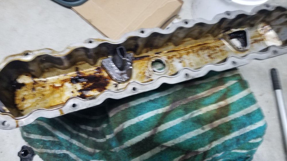

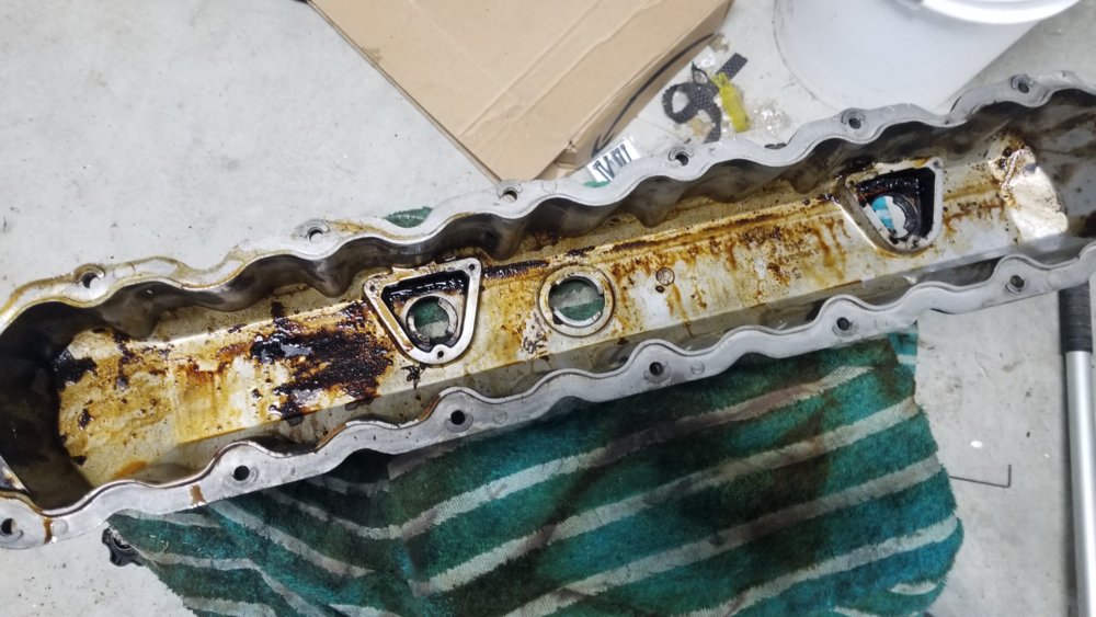

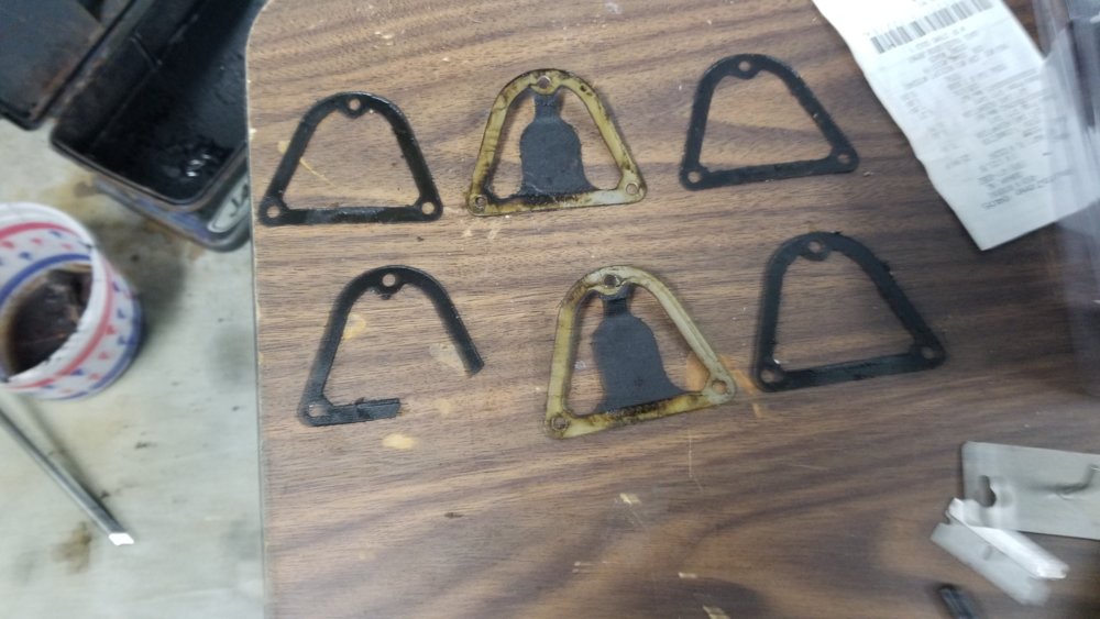

I'm fixing up a 1992 YJ with a 3spd auto tran and a 4.0. when cleaning the valve cover, I unscrewed to port things with baffles in them that the CCV and PCV valves lock into. the Gaskets that were used are old and I would like to replace them but no one I've asked seems to know what part they are or where to find replacements. Any help would be greatly appreciated. I'm including pictures to assist.
Buy a sheet of gasket material and cut them yourself. Should be less than $10 for a big roll. Then you'll have gasket material for the next time you need a gasket and don't want to go out to parts store or they can't get it. Or just put them in without a gasket.
What ^ said. Or just use a VERY small bead of RTV.
Not even a bead of rtv. If you use it, smear a thin layer on with a finger, just enough to "paint" the surface. You don't want globs of rtv falling into the engine and clogging oil galleys.
