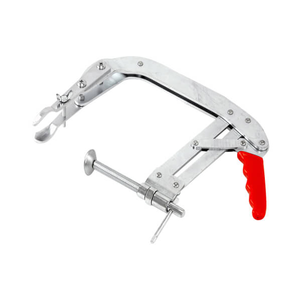

I've got this 7120 4.0 head sitting around so I might start going through it in hopes it brings some life into my tired old 258.
From what I can tell, the few things I will need that I don't already have to DIY this head is a valve spring compression tool and a valve lapping tool (and compound).
What do tool do y'all recommend? Looking on Amazon there are more variations than I imagined.
If y'all have any other tips and tricks to share that would be appreciated too. I've been reading this article as a guide: Video: A Low-Buck Cylinder Head Rebuild You Can Do In Your Garage

something like this isn’t expensive and works reasonably well. You aren’t doing production work, it doesn’t
need to be fancy.
and there is this...

As far as the valve spring compressor, I tried using one like is pictured, once. The issues were when tightening it down to compress the valve spring, the end wanted to open up, making it slip off the valve spring. tighten it up with the adjustment screw, and more often than not, it wanted to cover stem keepers. was a PITA. I really liked the pneumatic spring compressor a lot more.
