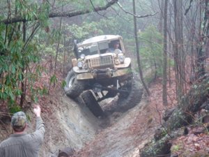

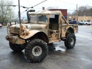

My truck is a 1963 m-37. I have a 350 hp chevy 350 w/holley650 carb. Mated with a custom made adapter plate,factory sm420 4 speed and factory np200 divorced t-case.dana 60 front w/30 spline outers 5:86 gears and a detriot.rear is a dana 70 w 3:86 gears 35 spline shafts and a spool. I made my own custom 4 1/2 inch lift blocks and rear traction/anti axle wrap bar. Sprung over. factory leaf springs,With rancho 9000's Custom home made driveshafts.Custom made front steering componts and a home made ram assist.On board air and 24 volt welder.factory lu4 7500lb pto winch.I also took hummer wheels and cut out the centers and ordered 8 lug pressed centers and welded them in also doubble beadlock pvc .inserts.Custom snorkle.39.5 boggers flowmaster exhaust.It's not done yet but it works pretty well. The only downfall is it weighs 7,500 lbs!
Bob , where's this little beauty at:confused:I remember its last breath of air between guardrail and helicopter pad. It took a big :poop: after you layed the skinny pedal to her!:driver:

Taking a...............................
Yes I did come in 5th but that was with less mods. And yes the other toy did take a big:poop: on the trail,the stock drivetrain can't handle 37' boggers!
There is another video on youtube . If the link above the first pic dosen't work type in 'Bob running the gauntlet' and it will come up.
