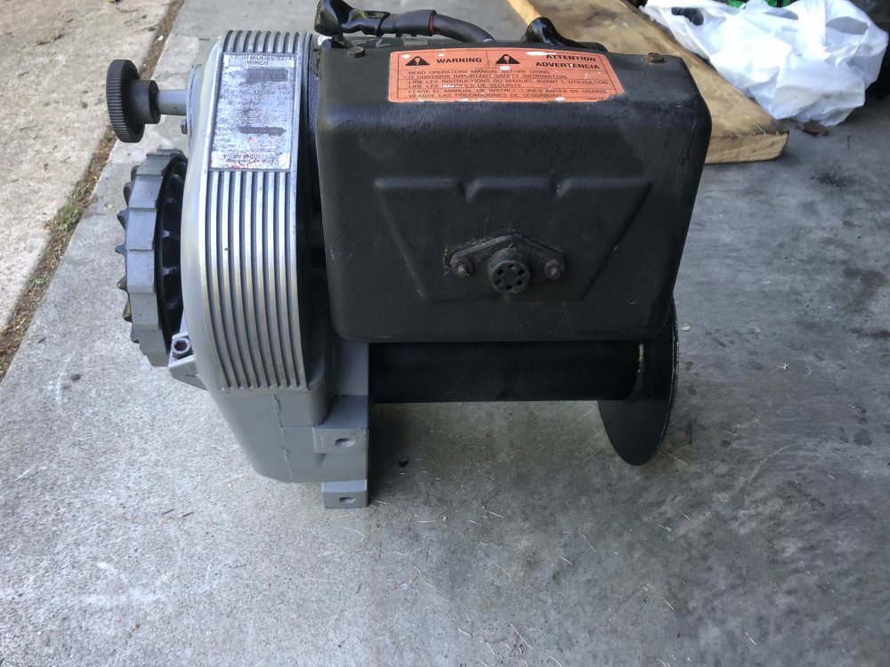

looking to wire an Albright on my Warn 8274.... 4ga is so much easier to work with and tucks in nicely under the stock cover! 2ga is a pain, but will carry the current! What gauge wire should I use for the solenoid to motor?

An 8274 can draw some serious amperage. Obviously, I'd do as heavy as you can with the wiring and probably make hot and ground the same size. They're both equally important.
Those wires are only 6" long. You're not going to see significant voltage drop/internal resistance.

I’m guessing the longest motor -> solenoid wire is 8”. Otherwise, they’re 4-6”.
4ga work on the short of a circuit?

My recollection is that those wires are 4ga direct from warn, even on the new ones with more powerful motors.

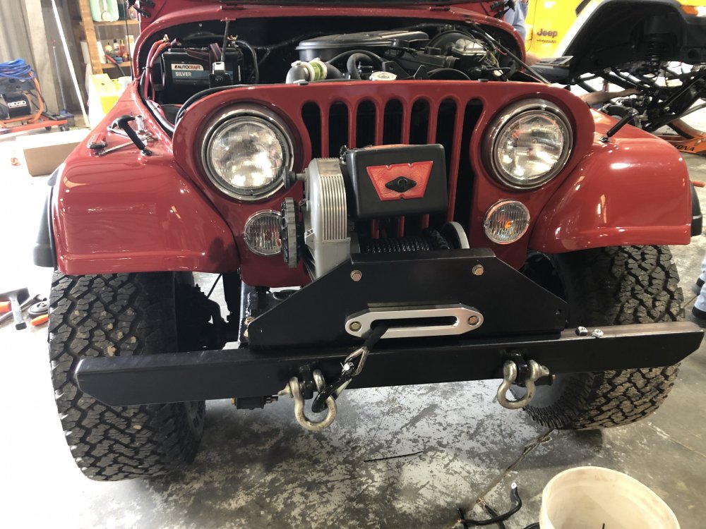

Aside from shooting some red onto the “W” and dropping her onto the front bumper... she’s essentially finished.
