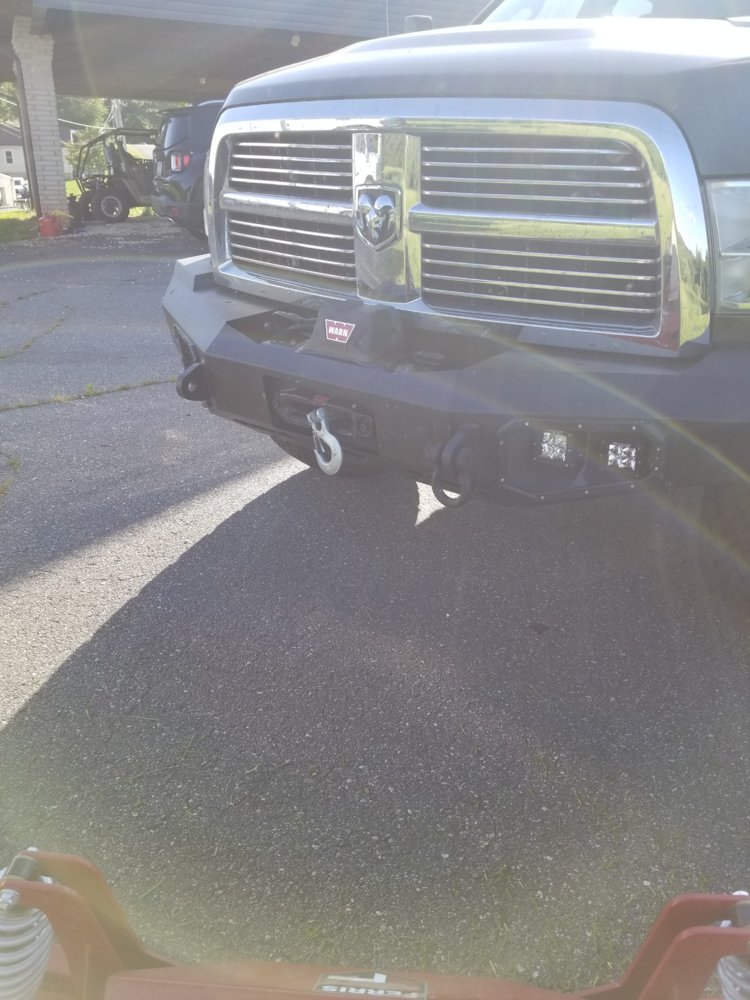

Is this the same winch y'all are talking about? I hope not.
I was mowing and lazy. I found the manual and it is in fact a vr10. I've said for a decade that warn is over priced over rated China junk, shoulda stuck with Badlands.
It looks like the old style.
