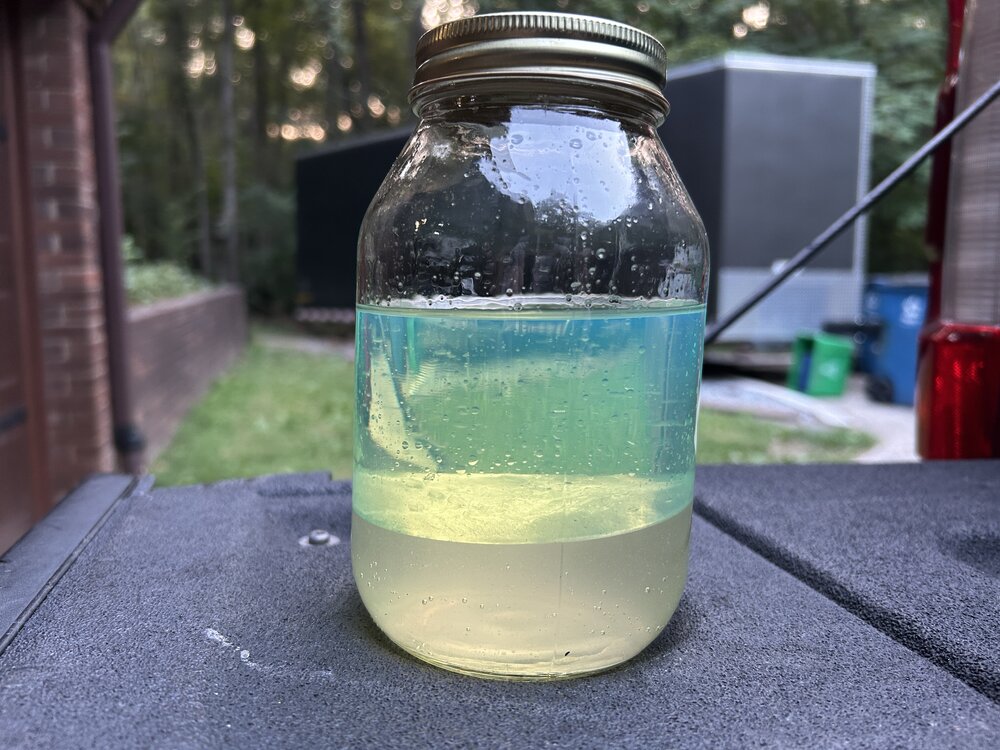

earlier this summer the water in fuel light came on. I drained the separator and replaced both fuel filters.
Yesterday the light came on again. I drained it this morning.
My questions: do you think I just have a quantity of water in the main tank and both of these times are from that and eventually I’ll get it all drained? Anything I should check? Any treatment I can pour into the tank?
i’ve had a diesel truck since 2010 and this summer is the first time I’ve ever had to deal with this.
Is the tank easy to drain? If so, I'd probably drain a sample out and see how that looks.
Reconsider where you're getting fuel. The water is heavier and generally sinks to the bottom (some will dissolve/mix with the fuel and can cause vapor lock issues). The pickup grabs whatever is at the bottom of the tank first, which should be most of the water.

For sure get fuel from a better source. I've never had that much water drain from any of my diesel trucks combined. It had to have been pumped in there.
