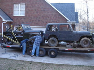

Just wanted to say welcome to the darkside, Ron. Start pulling parts of that K5 and raise the Jeep.
Full-widths all the way.:driver:
Here is your before pics. You will have to keep us up to date with the progress.

Yes it has a mobile home frame and axles. CJ7jakfitch and I own the trailer. Pulls great behind my dually or behind his F250. Oh yeah and welcome to the darkside Ron.

And to whoever asks, the trailer pulls awesome. I really think Jay and Lee could make a nice supplemental income trailer building on the side..:beer:
I need a trailer like that for my two Jeeps. Does it have a mobile home frame and Axles?
The only thing with the mobile home frame is when you build something 25 to 30 feet long you have to double the outer rails. The outside of the mobile home in my opinion is not strong enough over that long a distance. So if you want a 25 footer get a 50ft mobile home frame. Also the wheels are not DOT approved so be ready to fork out $450 on some DOT approved trailer tires. Just make sure you get some good rims off the mobile home.
