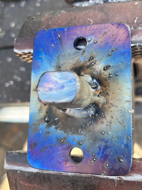

I know a couple of y'all have this welder. Pretty sure @mcutler has one. I've had mine for about 10 years now and I've struggled with this thing since new. I had a buddies Miller here for a couple years and it was great, I had no issues with it. I can not stand this POS. BUT I just need to get it right I guess. I need a new gun and cable because the wire is getting wadded up and pushing the whole thing out of the socket. Any recommendations other than the stock one? It has a Magnum Pro 175L
Also it welds pretty hot. It has automatic settings but I have to set it lower because it's burns like it's welding 3/8' material all the time.
I'm not a great welder but I can not find a sweet spot with this thing and get any better because of wire feed issues and running hotter than it should.

Liner is correct for what I'm running. I have run .035 through it before but usually run .030. I made peace with it today and used it all day because I need to finish what I'm doing. It spit the lead out of the machine 15-20 times. My welds look like shit but I got to move on...

Well how about this, I put the new liner in and adjusted the length per the manual. The old liner was a good 1/2" longer and I had to push it back in the gun when I would take the diffuser out in the past. The new one fit perfectly. I ran .030 through and it did much better. I just put .035 in and I'll have a bit of getting used to it but I can tell it's MUCH better. I have hated this welder since day one. Who knew that it would have come from the factory set up incorrectly? It's the only mig unit I ever owned so I didn't know any better.
