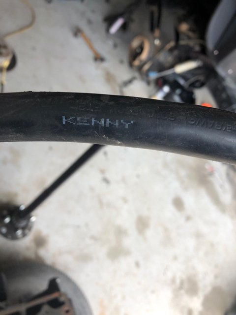

So since we are talking about it, this is what I use. 50'
Thoughts? Never had a problem running my spectrum 375 or millermatic 175.

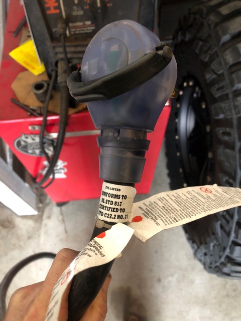

I like the plug with a handle on it,does it work well? Dont have a pic but he made one with a double box on the end. One side for the welder the other for the grinder or what ever 120.

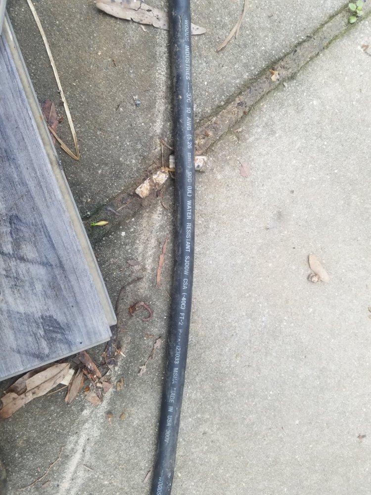

I ended up buying a 50' 10/3 cable off eBay for 82$. Haven't seen the quality yet, but just the 50' of cable would have been 100$ at lowes. I'm going to be running this from my 4 prong stove plug in the kitchen to my 3 prong welder in the garage. Is there a way to convert 4 prong to 3 prong without buying the adapter dogbone.
Cut one end off of the extension cord and wire this or similar on. https://m.lowes.com/pd/Utilitech-50-Amp-125-250-Volt-Black-4-Wire-Grounding-Plug/4068225
You just won't have a neutral wire to hook up in the connector, which isn't needed anyway since the welder is 3 wire 220V.
Thats the answer I was looking for. Y'all got me worried I'm gonna burn this place down. What do I risk by not running a neutral ? Ignorance is bliss until your mess is on fire.
