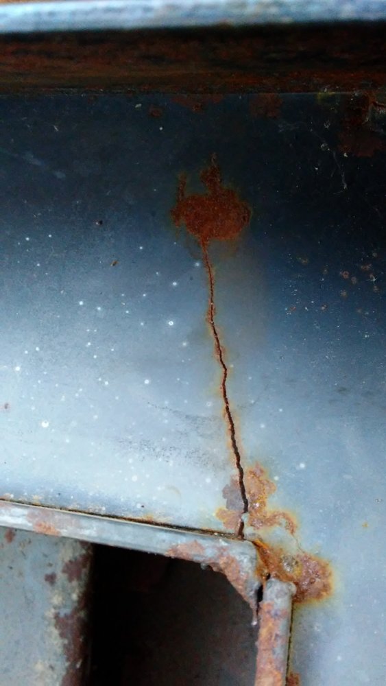

I'm buying a used WS and it has a crack about 3" long in the front of the stove above and @ the top,outside corner of one of 2 doors. Will the weld hold or will the heat/cool/heat/cool just crack it again? the steel is about 1/8" thick.

I realize my description is shitty. The crack is in the steel on the front of the stove it is the firebox. It cracked @ the right, top corner of the opening for the doors, the steel is 1/8" the crack is about 3". The doors are fine. There is a hood across the top of the door but there's enough room to get the stick under it. A hole could be drilled @ the end of the crack if that's needed, but it will have to be drilled from inside as the hood hangs down @ 45* and the end of the crack is up under it. If the crack needs to be opened up w a grinder, It will have to be done from inside as the hood is in the way, or could it be opened w a torch from the front. I'm also concerned that the steel has been through countless cycles of hot/cold and it might be brittle or not take or hold the weld for long? The guy is selling it for $100 and the blower works. There are also some cracks in the steel on the top of the stove around the flu. I plan to just lay some pieces of steel over them, the top is flat as a pancake.

Dude, taken grinder with a cut wheel. Dig that crack out, pull a 6011 down from the to the bottom and dig it in, especially when you start and stop. Just bury the arc.
If your slick, you'll weld inside and out in one pass.
Then, forgetaboutit.
It's not a water stove or pressure vessel....most take less care welding a cage.LOL....
It started from the corner being a stress riser and the related heat cycles. Grind to clean, wire brush first if your feeling froggy. Run,it hot and burn it in.
If it cracks repeat. If it's in a place hard to repair as it sits take a little more care. Other then that a single pass in a v-ed out crack and two stringers for overkill and call it done.

I thought about that, there are 4 screw type dampers on the the doors. I've never seen an insert w upper dampers before I assume the stove would just suck a small amount of air through the crack, w the upper dampers choked. But I also think the crack will grow and warp the piece of steel that is the front of the stove, it's already a bit twisted @ the crack now, if it twists much more the door won't be able to close/lock.This is the the stove but a larger version.
