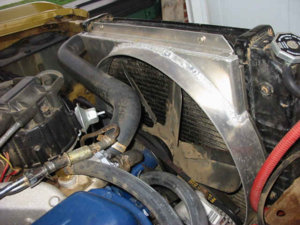

Like said before Aluminum can be tricky to weld. It heats up really fast, bows and stretches really easy too. MIG welding Al is not as easy as it sounds. I doesn't behave like steel. You have to spray arc. I prefer to Heliarc on most of my Al projects. It can be tedious on long welds, but if you take you time and don't overheat the metal you get a much better looking weld.
