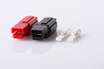

SAE Connector ? (amazon) mhhhh....

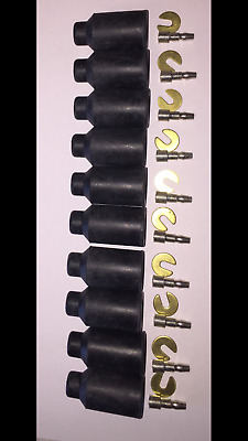

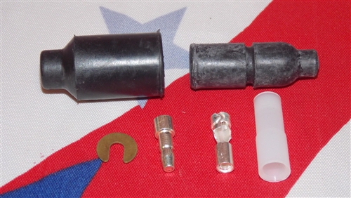

Some military m-series vehicles run 24v, my M416 trailer for example. The plugs look like below, link to one source - Military 14 Gauge Male/Female Electrical Connector Kit Packard M35A2 M818 M151
Another pic of the male end used in a specific application
