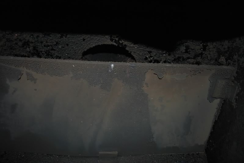

There's got to be a damper on it somewhere. If there's not, you need to install one. You'll never get any heat out of it otherwise.

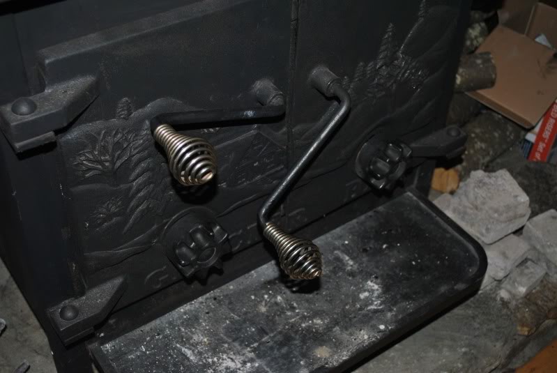

The only dampener I have on it are the two knobs on the front door, unless the dampener up top is controlled from the inside....

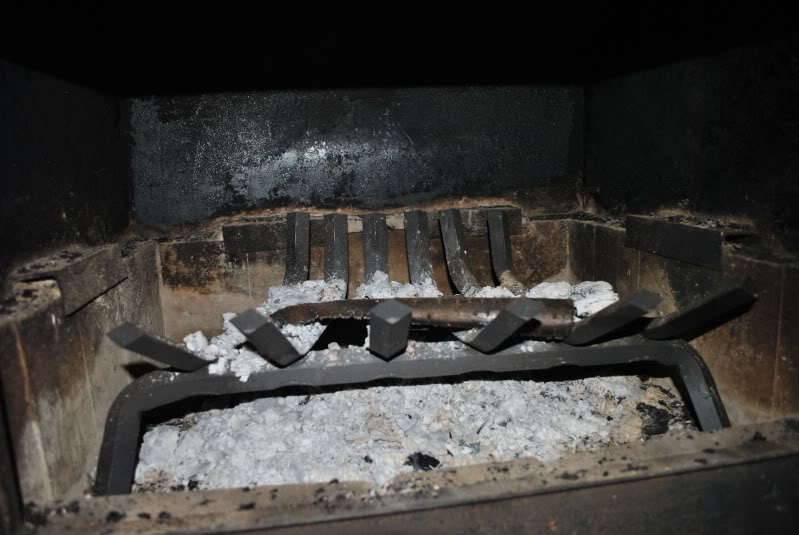

Sounds to me like your fire isn't getting hot enough. See if you can rig up some type of grate to get some air flow under the fire. I've also heard using a box fan to direct the heat around the room helps well.

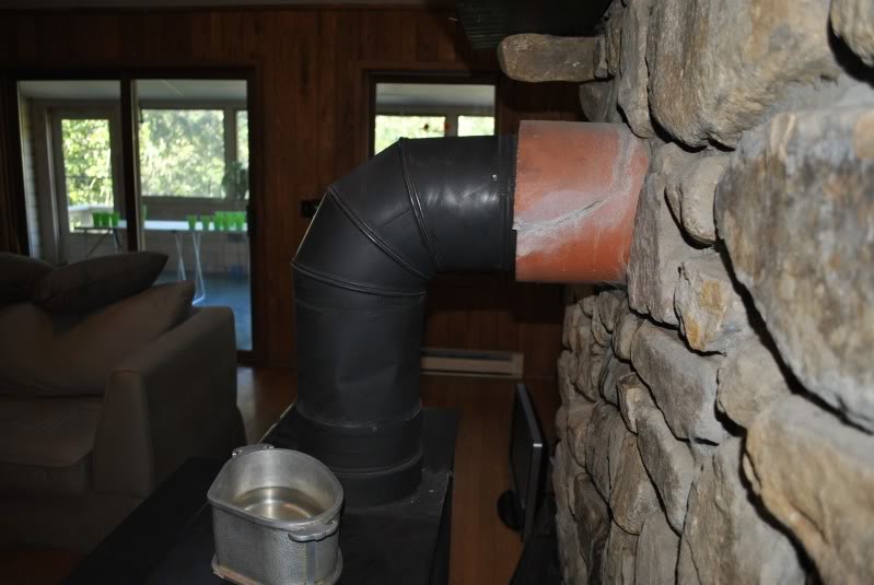

the dampner would be located above the fire where the smoke goes out of your house. if there is not one tell your landlord to install one. otherwise you are just burning money.
there is a metal plate inside the stove that I can move, but its basically in a set position as to which way it is oriented.
There is nothing at the stovepipe though.
i figure it will just be easier to show rather than to tell.
The knobs seen in the first picture are my only way to control air into the stove.
I believe one of our problems is that all the hot coals are falling through the new grate and arent keeping the larger logs hot.

How many pieces of wood are you putting in? The key is to have a small, but very hot fire. Start with small pieces of kindling. Get those going and use them to catch one or two small logs. Once the small logs are going and you have a good coal bed you can add a larger piece of wood. Don't overload the stove with wood. All that will do is produce smoke and damper your fire. If there's smoke rolling out of the chimney then you're probably doing it wrong. At least that's what I'm told. :D
Ok, you have no damper control, just draft (the knobs on front). Your best bet is to just run it with a decent firewood and use a fan to move warm air around the house with fans. That's the best you can hope for.
