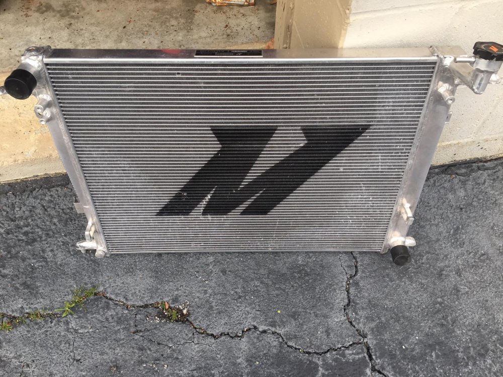

It’s mishimoto
Serial number search didn’t yield any results
Got it with a project I bought
Not sure what it’s for or if it will be sufficient in cooling a 5.3 in a rear radiator application
Any help appreciated
how about a pic of the tag on top of the core ? Any numbers on that ?
What's the dimensions and thickness on it? I'm sure somewhere there is a formula for thickness x dimensions = cooling rate.... But damned if I know what that is. I would say use your better judgement and see what happens?

You cant really get cooling ability from exterior dims, you'd need to know core tube size and length.

I just don’t want to weld mounts for a rear radiator and such then not be able to use it.
I may just spend a couple hours going through all the radiators on their site and see if I can’t match it up
A rear mounted radiator that likely needs to be sized according to low speed cooling completely by fan is going to need different core sizing than something for a front mount application for a street car. For mounting, etc., you should probably be looking for a universal fit radiator with a well designed matching fan shroud.
Hyundai Genesis Coupe 3.8 Performance Aluminum Radiator, 2010-2012
I'm not going to say it wouldn't work, but as cheap as a regular universal aluminum radiator is, I wouldn't base my vehicle build around it.

I'd say it's custom made & probably for the engine that it was intended for, when ordered.
Y’all are all spot on. It came with a rig I bought. Now I know I can sell it to some Hyundai guys. Lol
