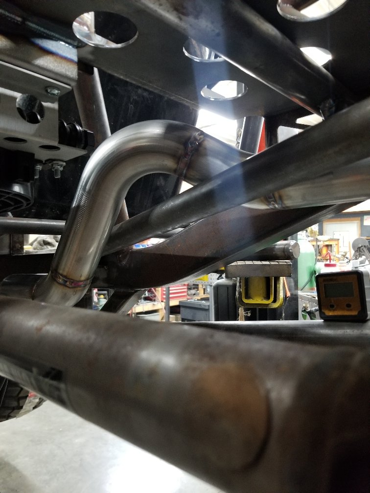

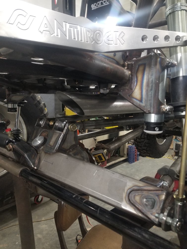

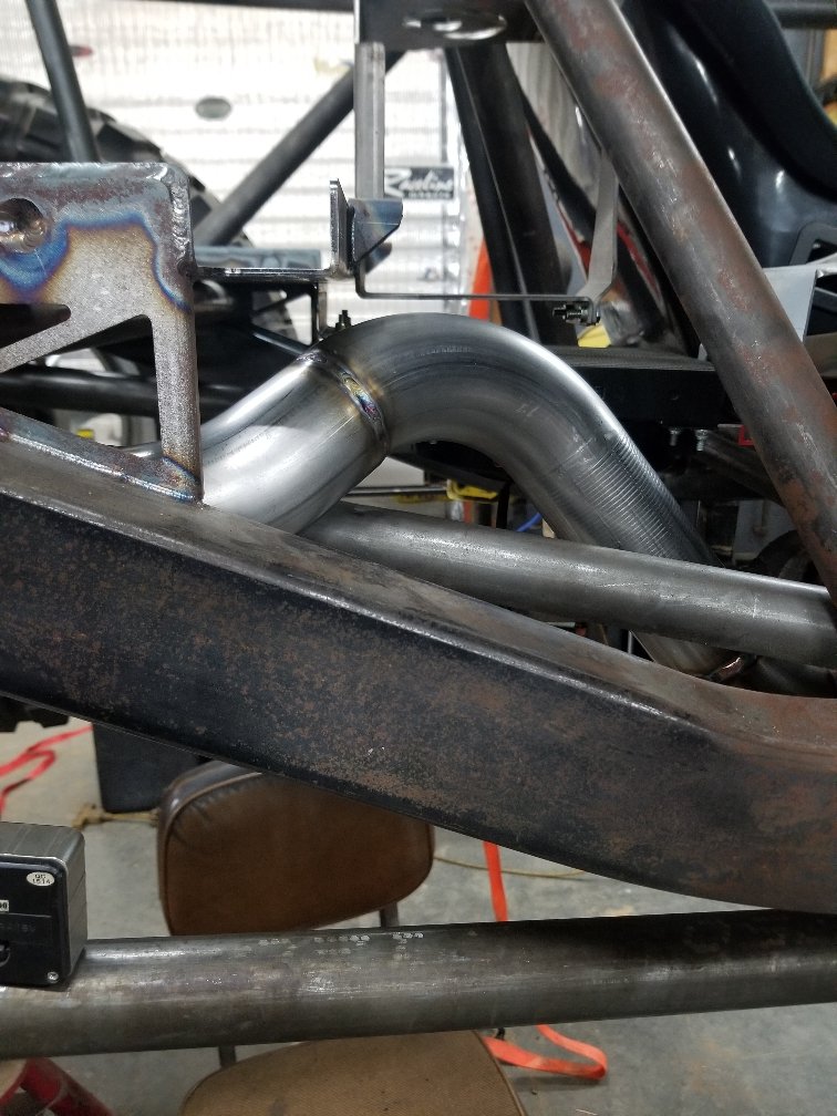

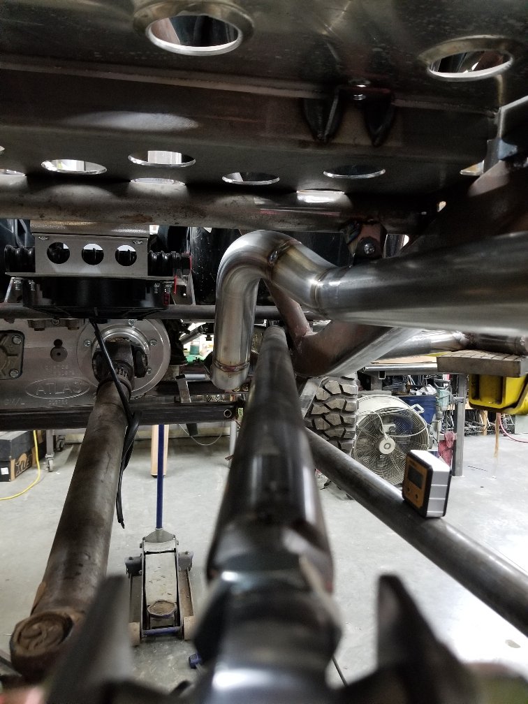

Full length buggy exhaust 2.5 SS, exits at rear tie rod, slinking around the upper link at full bump.
