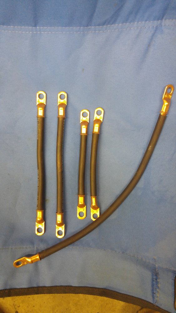

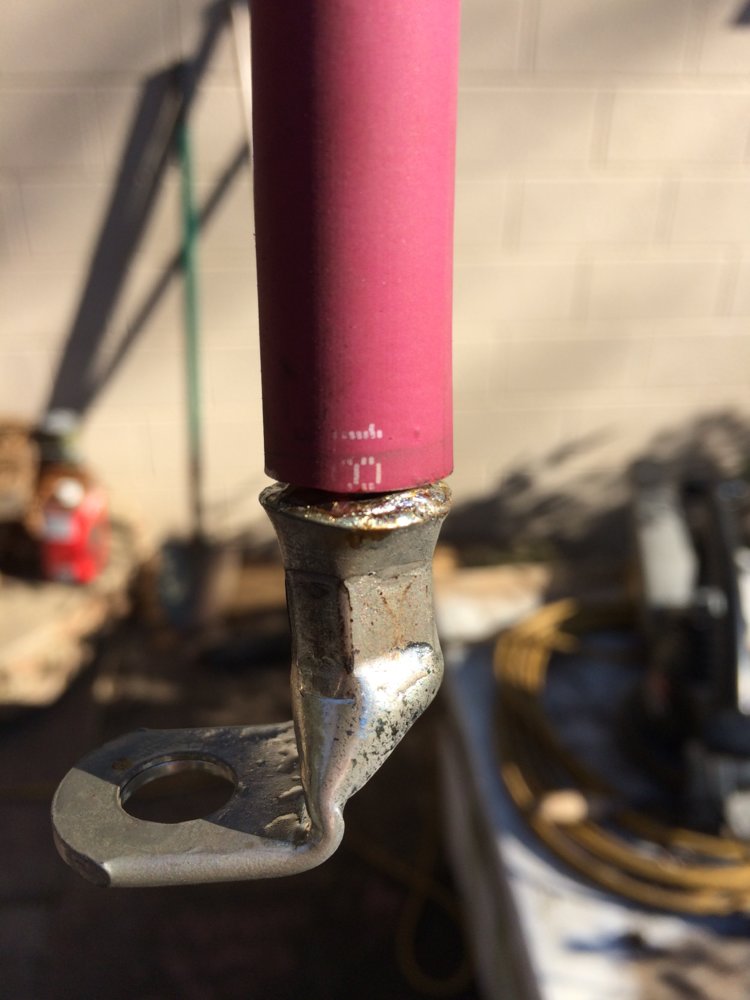

I bought pretty much that exact same one from HF off Amazon. Did a great job for me on my 4 and 2/0 wires.

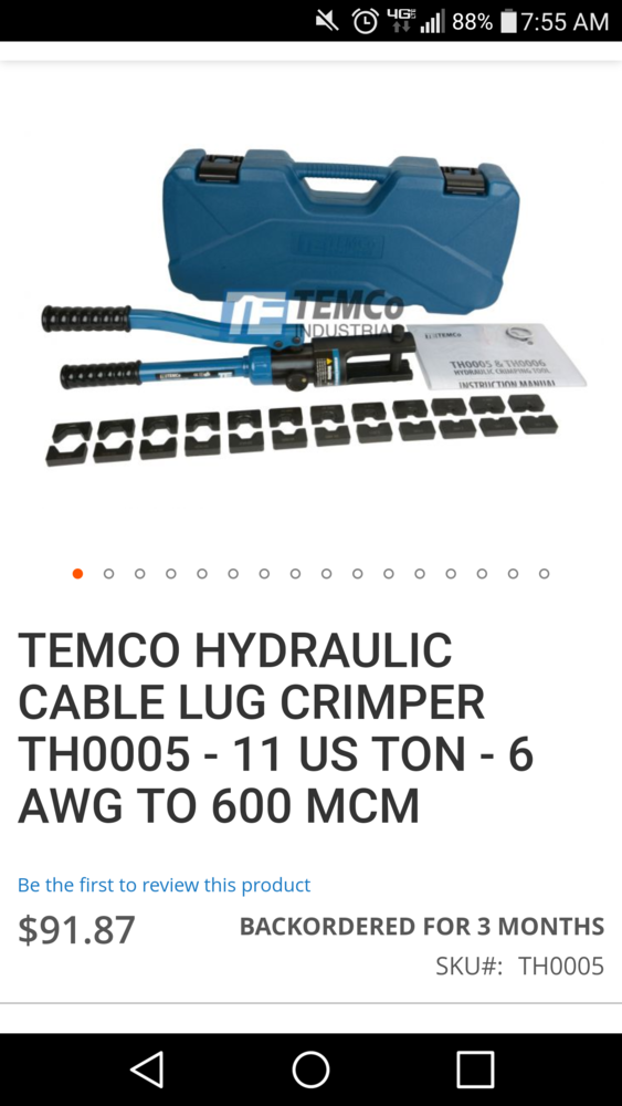

I bought this one. Got good reviews on the solar power forums. The harbor freight ones were hit and miss.

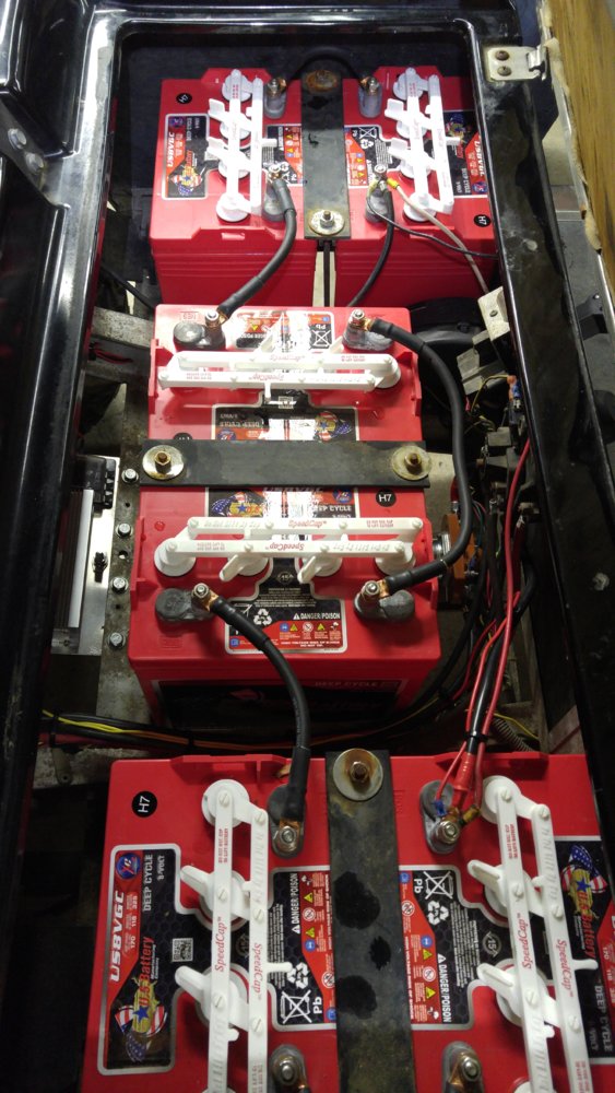

Paid for its self already. I made all new 2ga cables for the wife's golf cart for about $30. Was going to cost around $250 to buy them.
I have a 10T hydraulic one fro HF. Works wonders, like above it has more than paid for itself in making several sets of golf cart cables and starter cables for tractors, atvs etc. Havent had any sort of problem besides a circlip being missing when i bought it, .09 later i was good to go.
