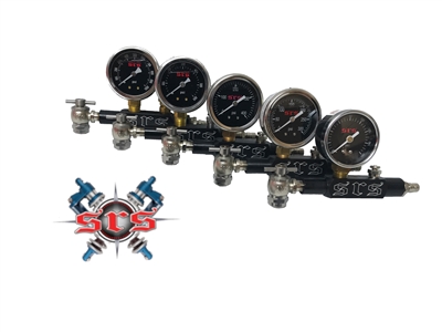

Gotcha. I saw another thread on here about putting a fill kit together. Looked a lot easier/cheaper than I would have guessed based on looking at website that sell this type of gear. Do I really need something like this to fill up my Icons to 200psi:
Or will this simple regulator/hose/chuck setup work:
I dont understand why the separate fill tool thing is needed.
I just have a nitrogen tank with a high and low pressure gas regulator I picked up from the welding supply along with a 10’ long hydraulic hose and a high pressure air Chuck. Was pretty cheap to put together. Not sure if any of those other kits have anything more than necessary or know how they work as I don’t have any experience with them.
