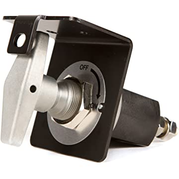

Thinking about installing a switch to cut power to my winch while I’m wandering around town….
This is one option I’m considering. Should I go a different direction?

Get a Bluesea PN 9003e
Works great and the ratings are actually true. Takes 350amp continuous, 600amp during 5mn and 1200amp peak during 30sec.
I've been using it on a big winch with great success.

I've used a few of these. Never had a problem with one.

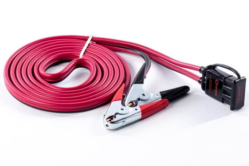

Another option would to use some quick connects like you'd use for a winch you have set up to go front and rear. I know several including myself that have used these @Jason W. and @josh$$
That's a good idea.
You can even make some cool stuff that plugs in the quick connects and use them for more than just the winch.

That's a good idea.
I have two 20' extensions for my Ready Welder. I can use the connection piece for a jumper. I have run into connectors that take the same size cables not fitting together because of a slight difference in the plugs, but, a little work with the dremel, and you are good to go.

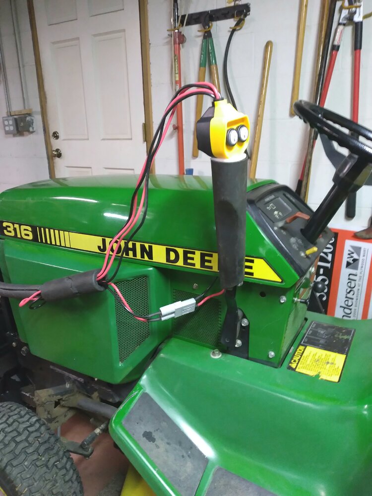

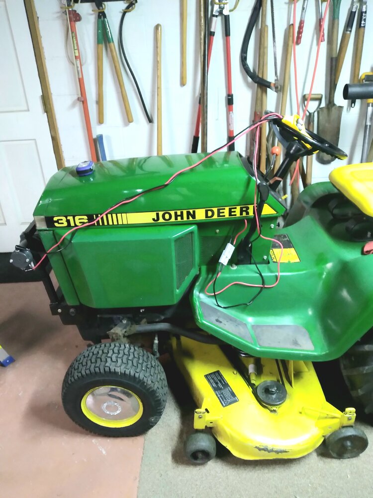

I got the Mini's, so I can easily take the HF utility winch on & off, which raises & lowers my push blade.

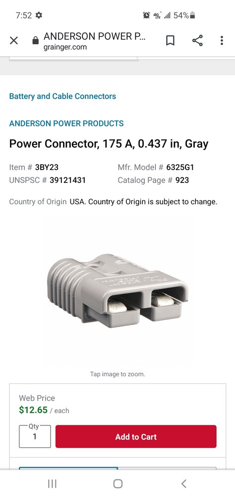

I can also vouch for the Anderson Connectors being a great option. I use them in the industry but also have used them in the past on my XJs winch set up.
