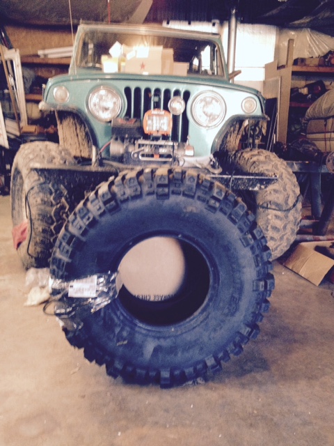

Here is the Jeepster before the change. It had Currie 44 and 9" both wide track CJ width with spacers for more width. It was spring under with 6" lift Alcan springs. It was scary unstable in the rocks. I actually got pretty good and saving it from flipping or flopping over the years with a reverse drive out.

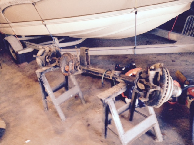

I bought a used and built full width front Dana 44 for the front. All I need to do is to convert it to 5 on 5.5" and remanufacture the steering to fit the Jeepster.

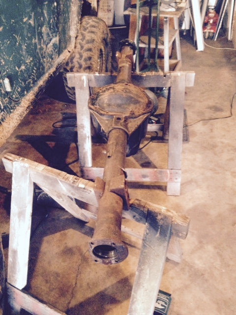

I have an International Travelall rear Dana 60 SF that I've had here at the house for years. I'm converting it to 35 spline axles and adding disk brakes. Also adding a spool and 4:88 gears.

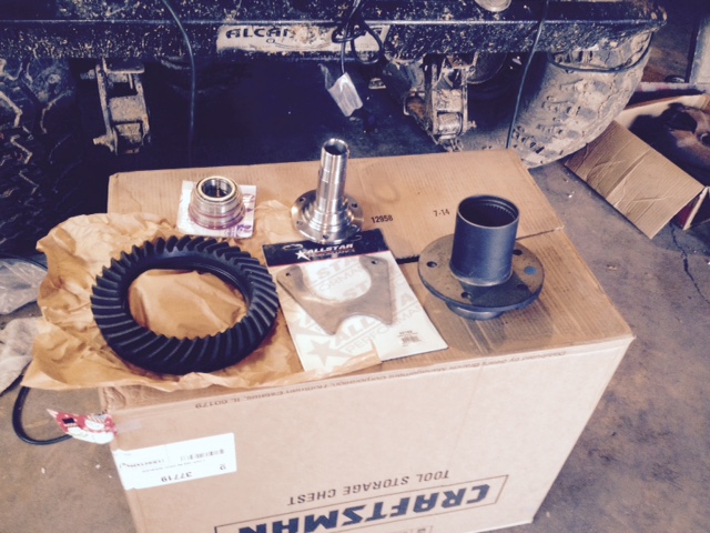

Here's a few pics of the purty parts I've been gathering...

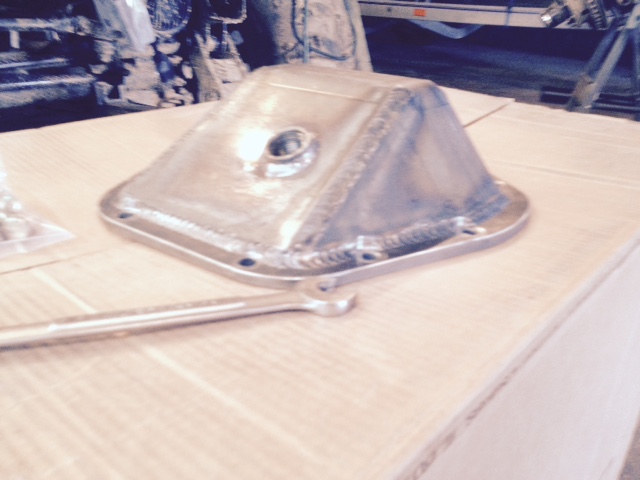

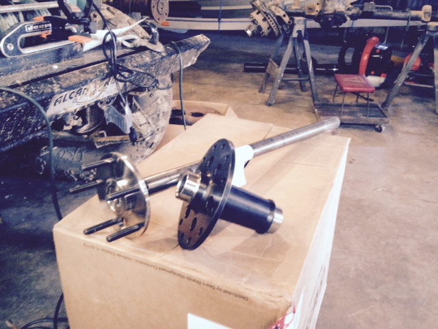

Custom Cromoly Moser 35 Spline axles and spool

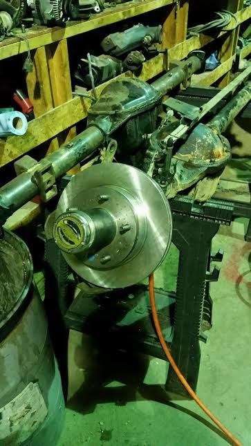

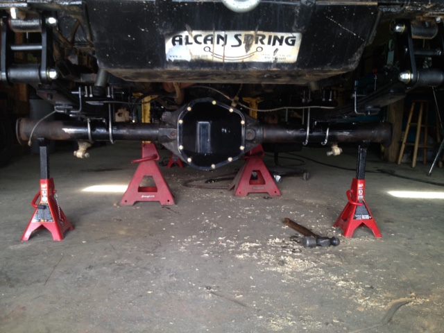

Here's what the 60 looks like under the Jeepster. Mounts are aligned better, new springs are installed. We had to shave a bit off of the axle flanges to make the brake rotors fit properly so waiting on them to be finished.

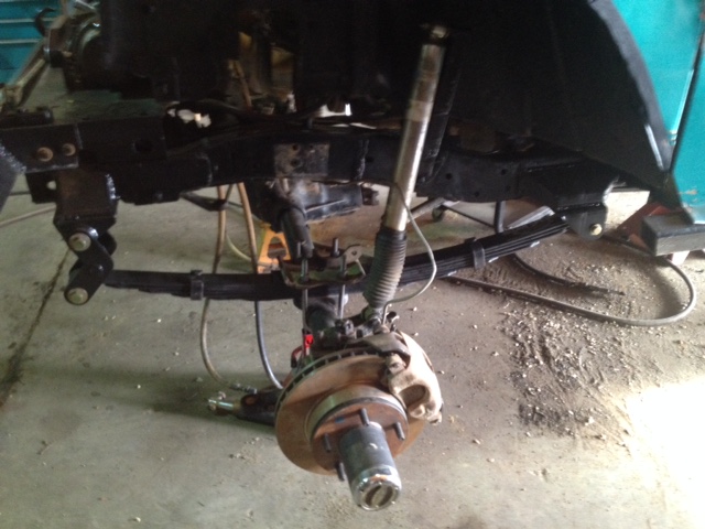

Here's the front 44 in place. Mike Z. did some great fitting and welding so it will all be aligned and fit properly. We are waiting on one little steering part from Go Fer It Offroad before we can proceed with the 1-ton steering.

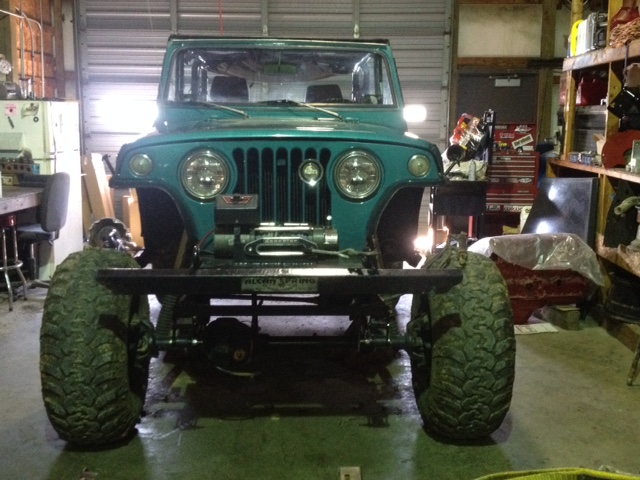

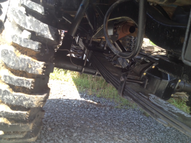

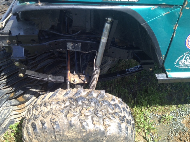

Here's how it will sit in front. It's a bit wider than it was before. With the trick new SOA Alcans it will be a LOT more stable. I had them built with a reverse eye so I would have more arch in a stock, no lift spring and I also had them military wrap the front of the rear spring and the rear of the front springs. It's kind of like a buggy spring application but not really, you'll have to see it to understand what they did. I'm excited and cautiously optimistic on their performance.

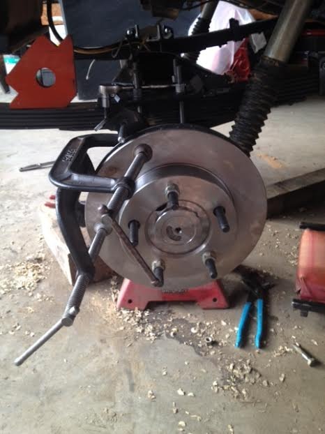

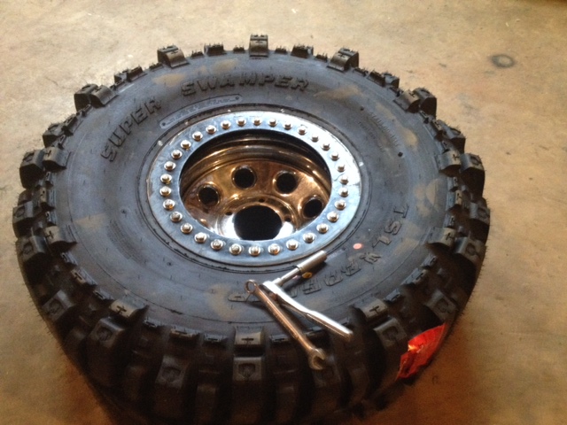

LOts of progress this week but only a couple pics. Rear disks are on and functioning and had to mount the new Boggers on the beadlocks

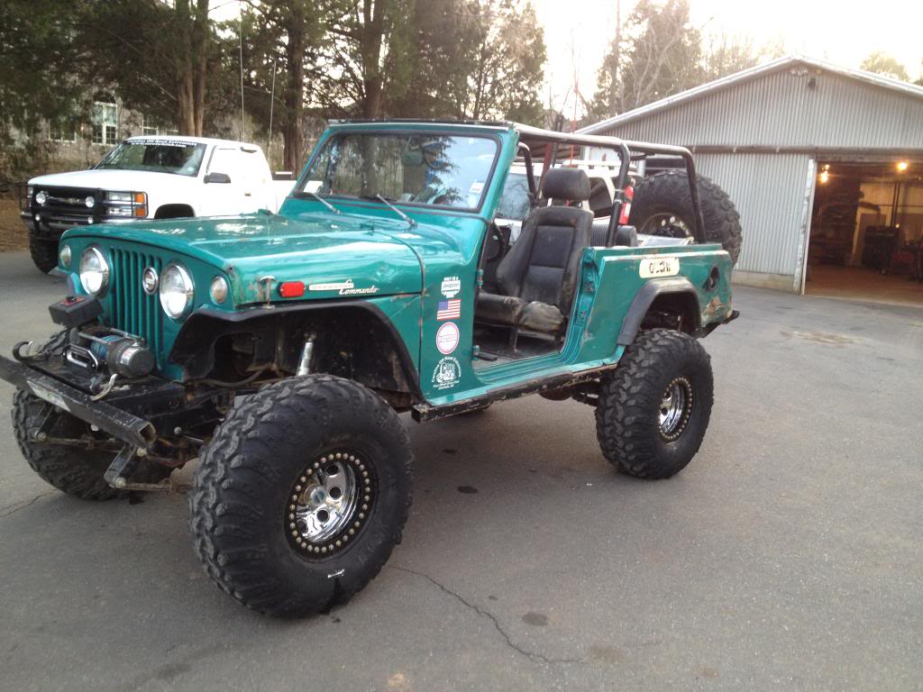

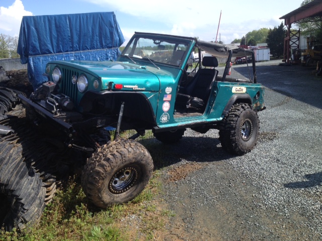

I picked it up from Mike Z's last night. It feels GREAT! Very solid, not too stiff.
A shot from the rear while it's flexed on the tire mats
May need to look into some bumpstops bro! Even those Alcans won't gonna take kindly to repeated negative arching before they stay that way... like mine :rolleyes:
