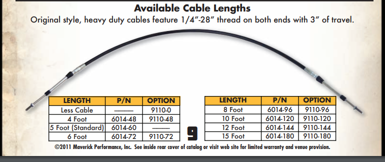

So, I have a gated winters shifter in my Crawler. Somehow, my shifter cable fell down on my exhaust. Melted it pretty good. Which in turn, makes shifting gears a PITA. Wondering if these use a factory cable, or something of their own design.
I really need to replace it.

That's great... just thought I would put some info here incase someone searches it in the future.
