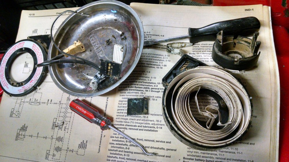

For those who wonder what the insides look like
