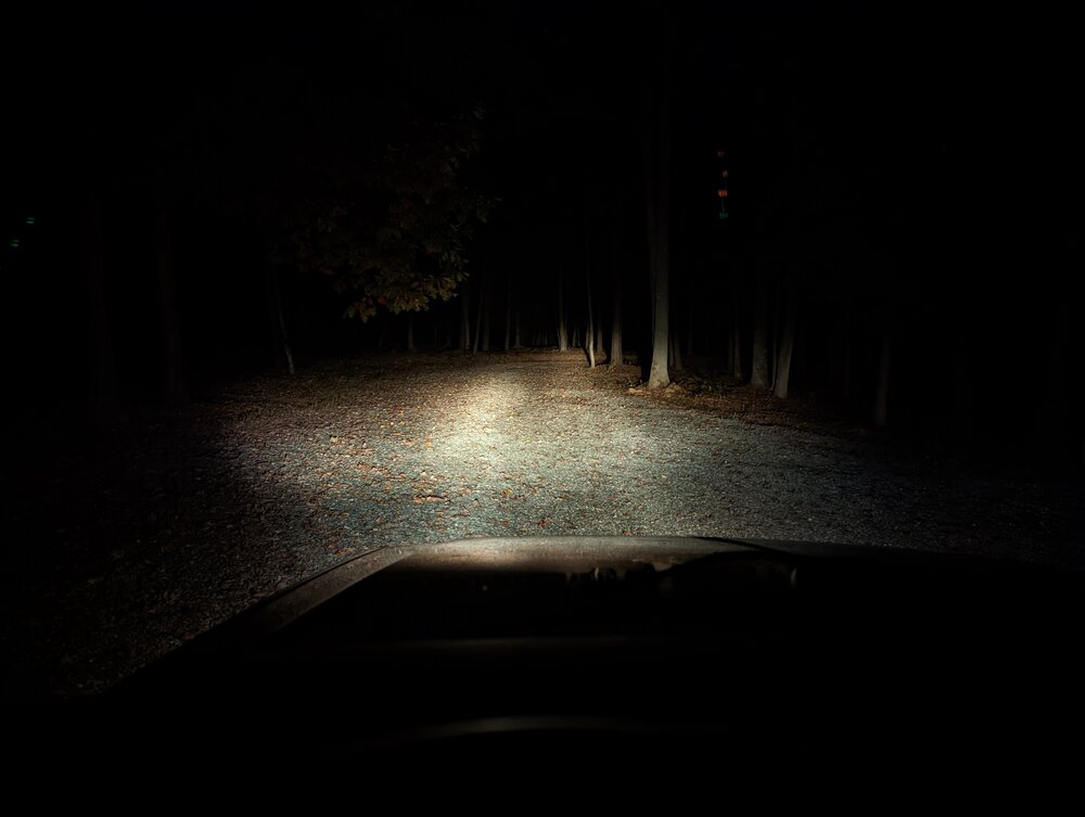

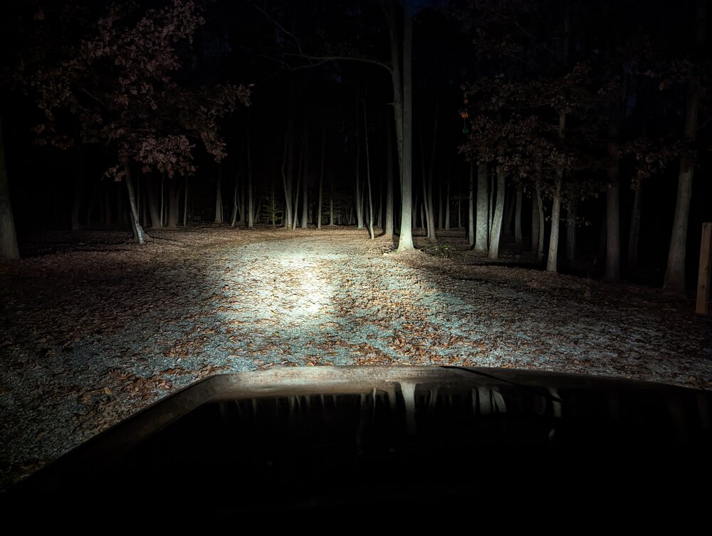

Swapped in the harness and the new e-spec hella housings and H4 bulbs, what a difference! Pics below, both high beams (before and after)
I still need to aim the lights a bit better, but the overall coverage is great as is.
