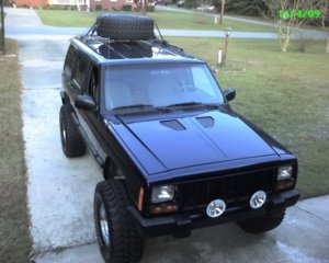

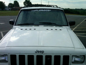

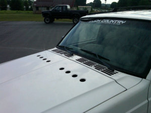

no. found them on google. just looked at a couple, maybe not so bad installed after all. but for sure dont cut the supports out.

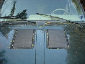

Go to Lowes in the HVAC section. Get an air return grille. Get the one that is supposed to bolt to the wall. Paint it. Mark your hood 1/2" smaller than the grille and cut. I turned mine backwards to act more as a heat extractor instead of pushing cool air in.
