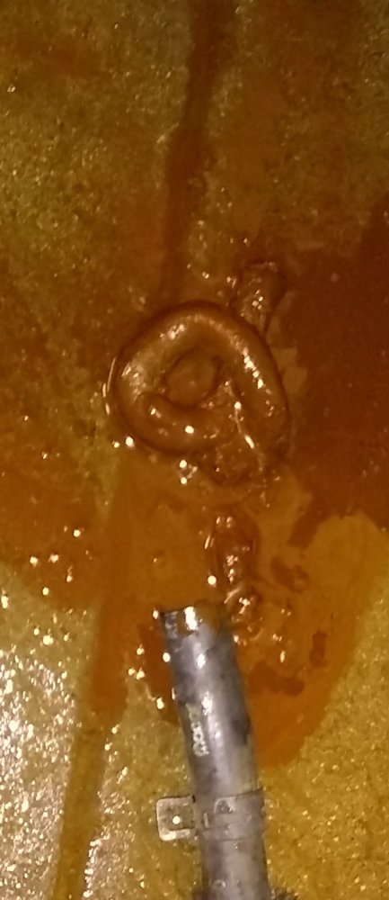

Heater hose had a turd in it.
Heater had crap in it. Flushed clear. It throws heat now..... It will run hot @ idle or 2000rpm, just keeps creeping up;;. Verified with scanner that it is indeed getting over 230. Upper hose gets hot, so I know the tstat is opening. Heater works, so I would think the water pump is ok. Upper and lower radiator hoses are not discernably different temperatures.

I'd be checking the water pump and fan clutch. Also that is one nasty turd out of the heater core.
Fan clutch is pulling air for sure. It engages harder as the temp climbs, so I don't think that's the problem. Going to pull the pump here in a while. It had been replaced but it's been some time.. and I've got no idea how long it was run with plain water in it. The turd was combustion gas deposits from the blown HG & cracked head.
