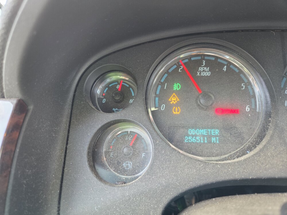

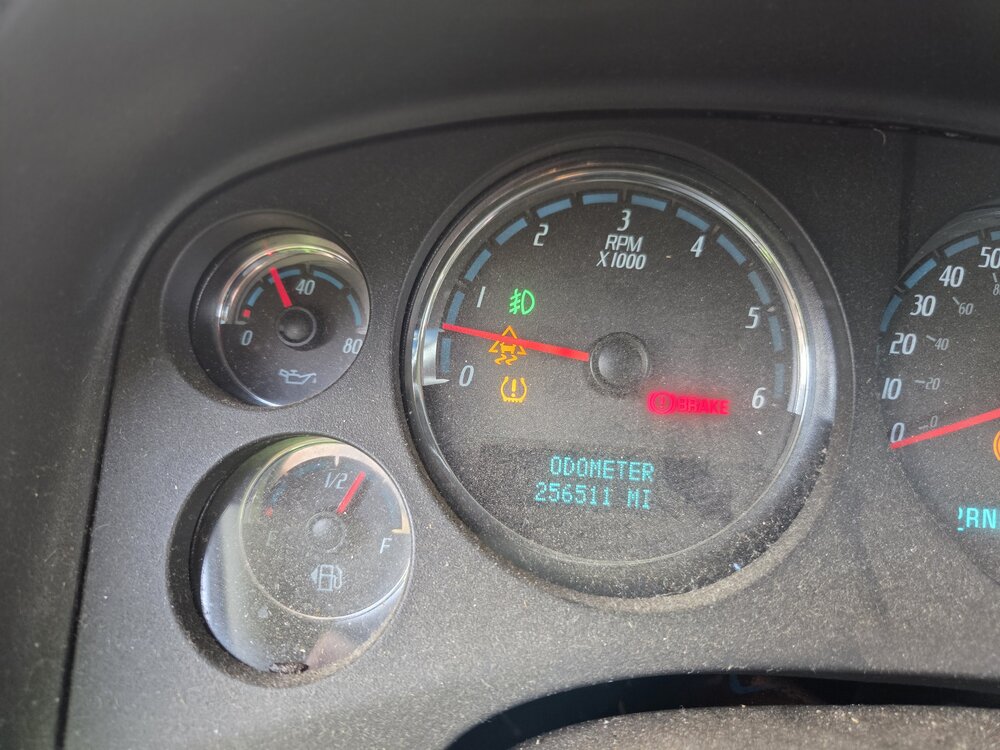

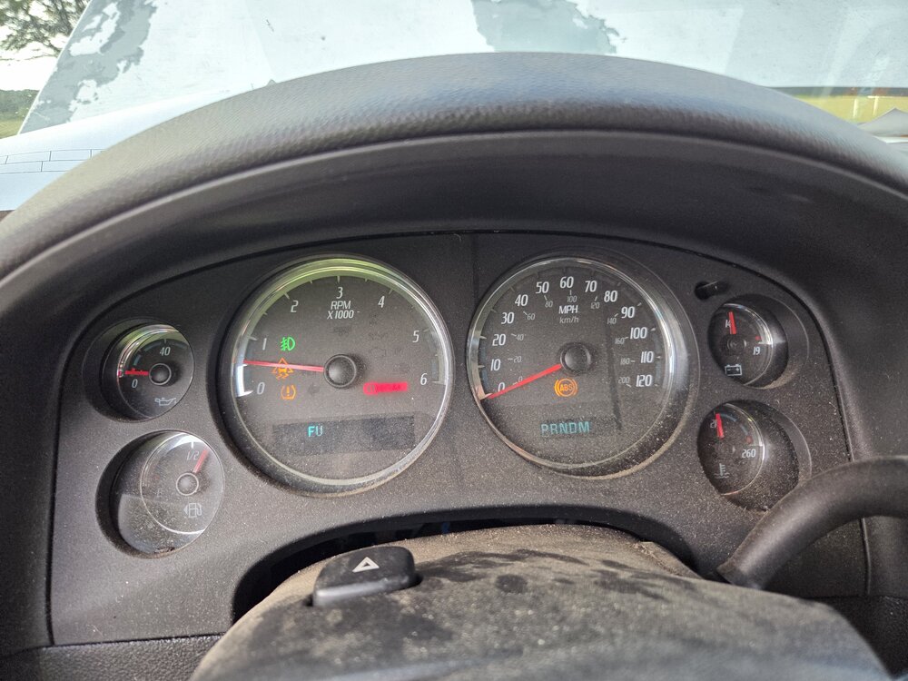

2007 GMC Yukon XL Denali with the 6.2L gas engine 256k miles. Oil pressure is tanking at idle, sometimes. Will be running fine then oil pressure will read zero and give prompt to shut down engine. No new tick or knock when it does. Just the same lifter tick these are known for. It'll beep on and off for a minute, and pressure goes back to normal with throttle application. It has plenty of oil and I put a new filter on as a cheap test. Any help is appreciated.

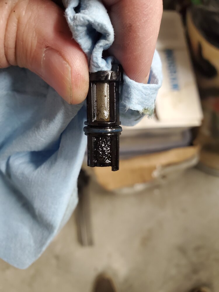

Pull the sensor and see if it has a screen under it. If not, put a mechanical gauge on it while apart.

That fixed mine.

If it's not the screen under the oil pressure sending unit, they do have a bypass valve that's built in to the oil pan. I've seen them hang open and bleed off oil pressure.
Thanks for the info folks. I'll start with the sensor screen and go from there.
This is the one that came out of my mom's 2007 5.3 AFM yukon. It would have pressure at startup but slowly drop to zero as the screen plugged up.
