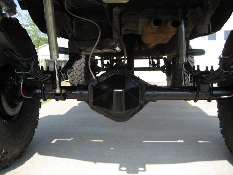

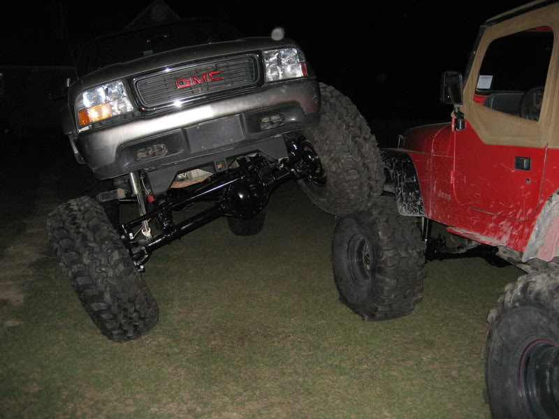

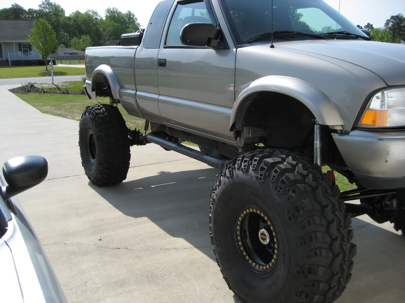

So its been a while since I have put up some updated pics.
So here it is..
-2002 GMC Sonoma ZR2 38,000 miles
-HP D60 front, 5:13's, ARB, all 35 spline, warn hubs, chevy brakes, 1410 yoke
-14 BFF rear, detroit, 5:13's, disk, ruff stuff diff cover, 1410 yoke
-Bilstein 12" 5125's, bump stopped and limit strapped up front
-4" Alcan waggie springs up front
-4" ZR2 springs in rear
-Custom 231/233 hybrid T-case
-High angle rear driveshaft 1350 CV/1410 @ axle
-High angle front driveshaft Toyota non-cv/1410 @ axle
-Eaton 32 Bolt beadlocks
-42" IROKs
OBA
And a whole bunch of other crap that I have already forgotten about.

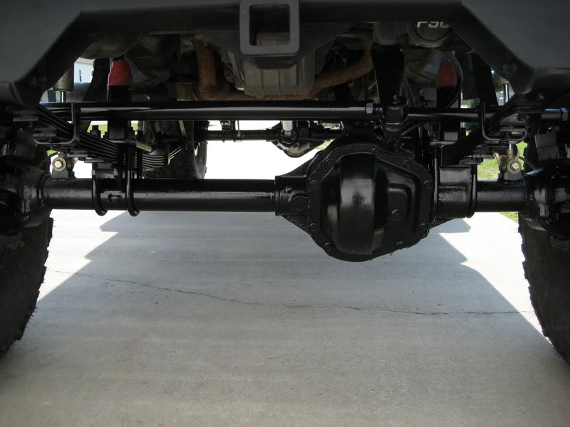

Love the look of the truck. Not sure what to say about the steering, at least its beefy.
Whats wrong with the steering??? I have zero bump steer and nothing binds up. The pitman arm is a Ford 4" dropped arm that was filled in and re tappered from the top for GM 1-Ton TRE's. All Tubing is 1.25" .25" wall DOM that was threaded "no welded in inserts" with Offroad Design steering arms and a custom PSC steering box. I know the pitman arm looks funny like that and looking back I probably would have just used a perfectly straight arm, however it does work very well. Just need some hydro assist for those low-rpm turns.
I didn't say or mean to imply there was anything wrong with it. Its just different, looks like it would work fine to me. Not sure if I could wheel a rig that looks that good, be sure to take plenty of those "before" pics;)

Look a little closer at the drivers side and you'll see where it ate a tree at Gulches. My ext-cab window frame is in their pile-o-shame by the front porch.
