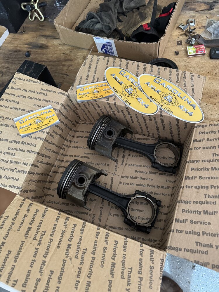

I have some here as well. Lemme know if you want me to snag one with the rod attached and snail mail it over.
(I grab 258s for the crank and scrap the rest).
