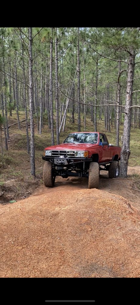

My buddy makes them on the side. Here is the one he made for me.

What would one run dollars wise? And do you know if the frame rails are similar from my ‘81 to your model?

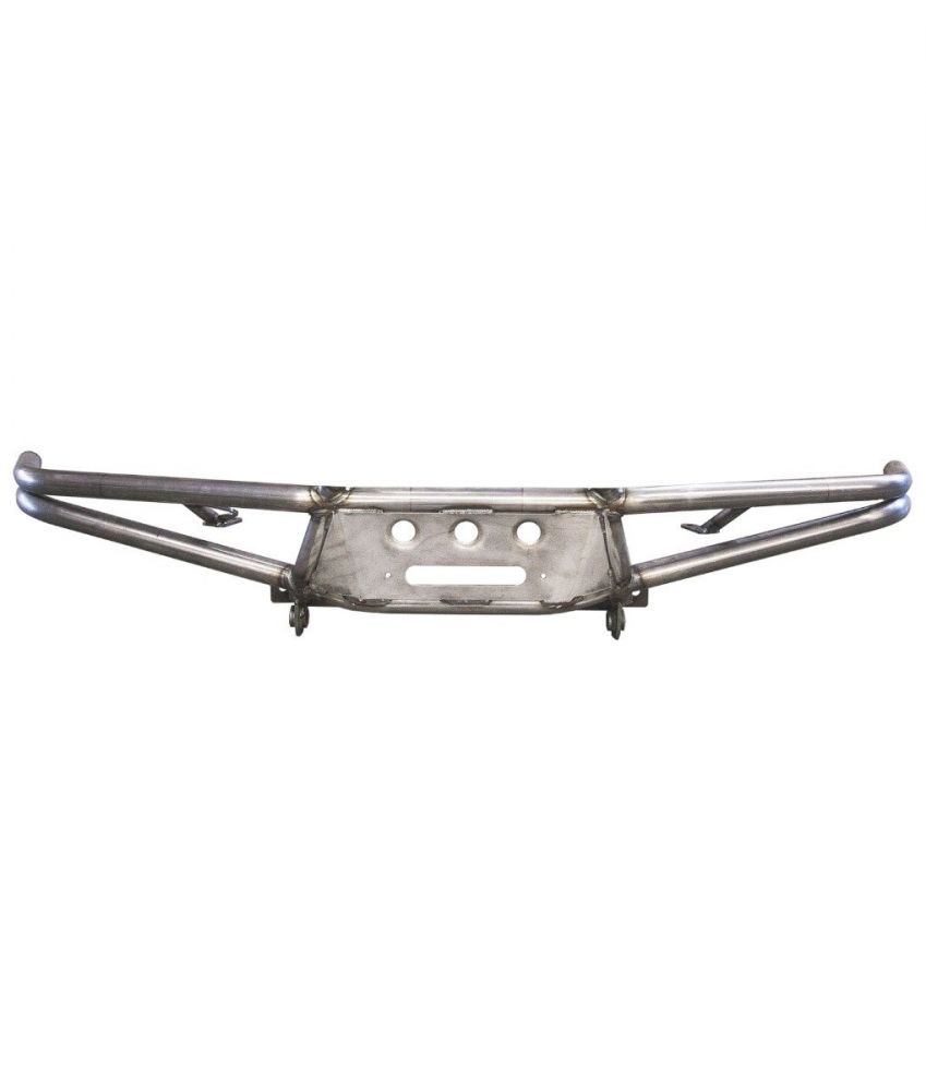

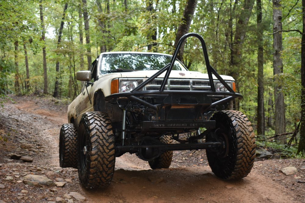

I found this one on All Pro and kind of what I’m looking for. Super simple I just don’t have a way to bend tube. I would be down with a stinger just not something huge.
I think they’re around $200-250 depending on how fancy you want it. I’m not sure on the dimensions aspect. I’d assume they’re not far off

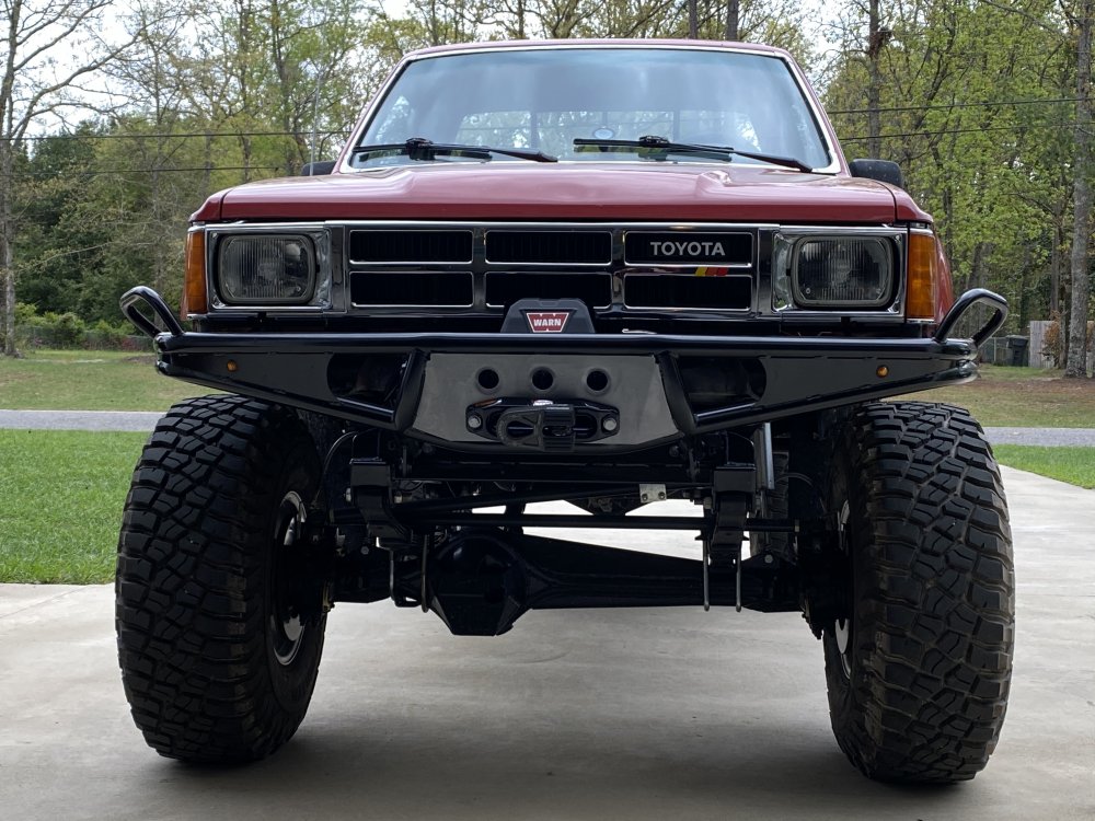

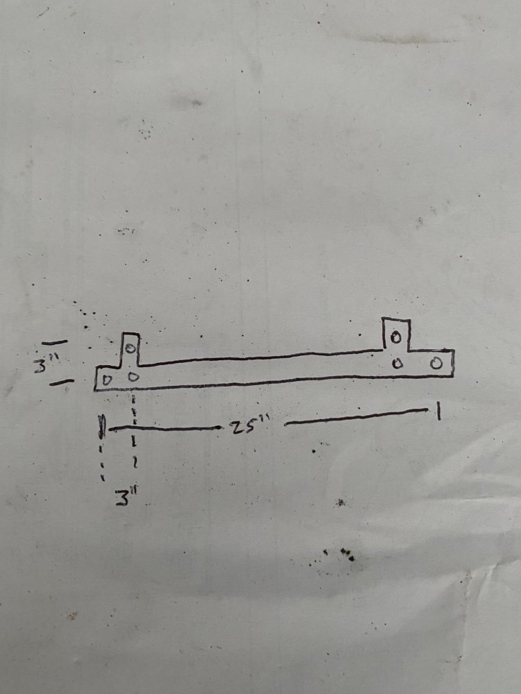

@dark knight I checked them out and they are for 84-95. If I could get some measurements I might could make it work but don’t want to spend the money just to have to cut it up to make it fit. If you’d be so kind at your convenience could you take some mounting point measurements? Also, the mounting “legs” that come off it go to the front body mounts?
I could maybe get the measurements tomorrow. A person who can make one from scratch is nick at NTK Fabworks. He did all the welding on my truck and did an outstanding job.

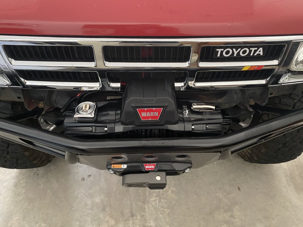

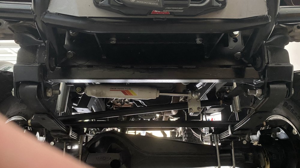

Mounting legs to the body mount area is roughly 33.5” apart.
outer most bolts are 25” apart. The is a bolt 3” to the inside of the outer most bolt and one 3” above the last. This is for both sides.
