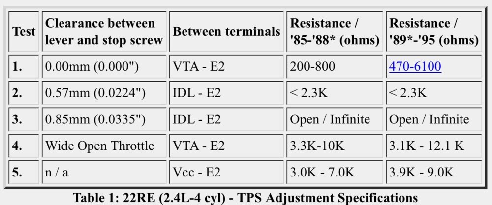

My 22re started running like crap last week. Starts & idles fine but takes forever to rev and makes way less power. Verified fuel, spark, air. Pulled throttle body today, cleaned, ohmed out TPS. O2 sensor is disconnected, but has been for about 6 months (rattled loose, fell on exhaust and burned up the truck side wiring harness). I'll splice it back in tomorrow to verify it's not the problem, but this was a pretty drastic change overnight. Exhaust is not clogged. The only code I've gotten is the o2 sensor.

TPS was good per this chart
