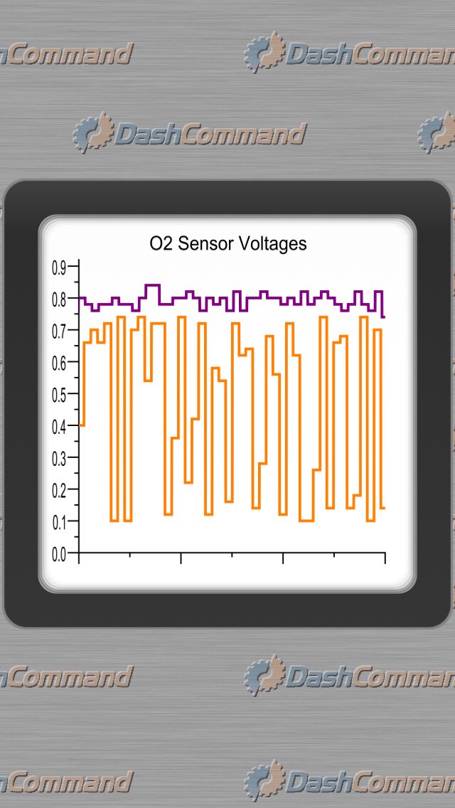

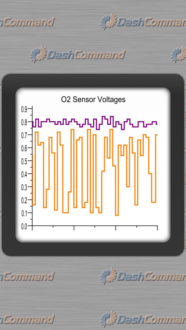

I replace all four. Pull the cable on the battery to reset the CEL. I don’t recall what my O2 sensor were reading before, but this doesn’t seem right to me after replacing all four sensors (cruising 70 mph on the interstate.
The downstream sensor shouldn’t be jumping around right?

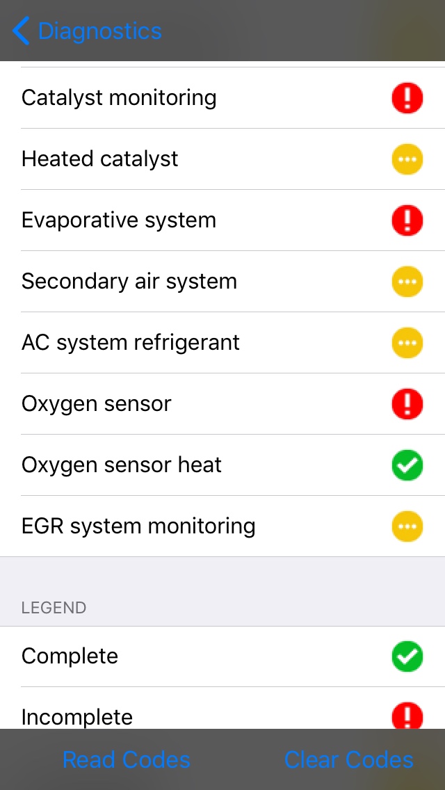

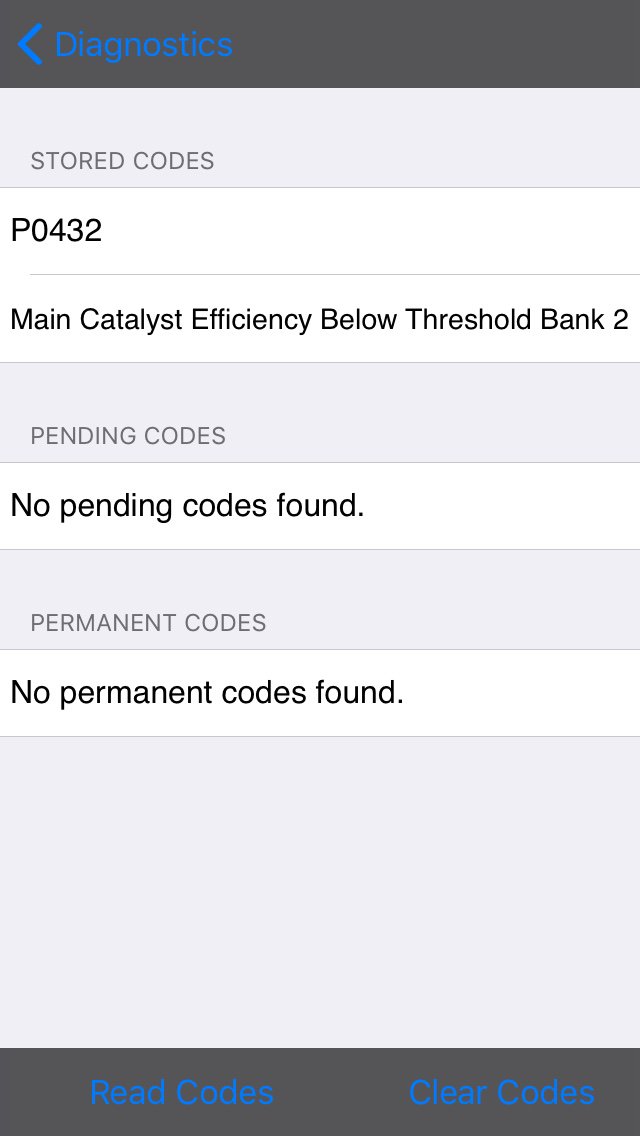

When my app does a scan it tells me this
Did the precats take a dump or does all seem well? (No current CEL) I drive 50 miles a day so I don’t want the ECM to be all out of wack.
If the downstream O2 sensor is flunctuating, you either have an exhaust leak between the sensor and cat or the cat itself is failed.
The flunctating signal indicates the outgoing exhaust is similar in condition to the incoming exhaust
Thanks Jody. I need to confirm which graph line is downstream Vs upstream. I currently have no CEL on but I’ll keep an eye on this.
