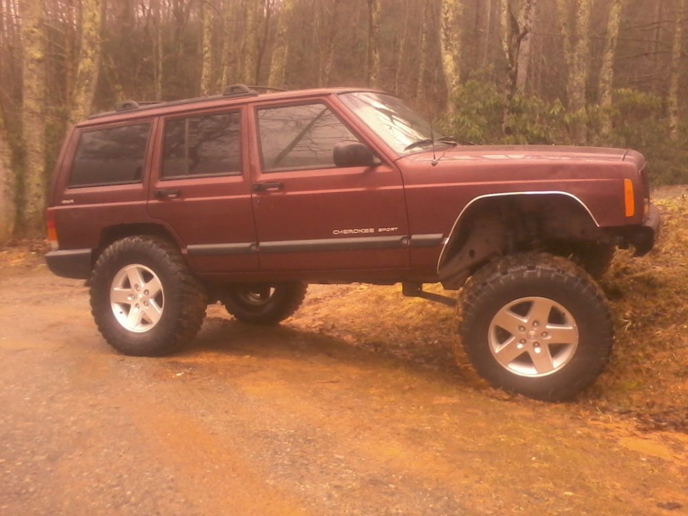

hey guys..i've done lots of research but as always end up with lots of both direction advice so here it goes. From what i got out of most threads on the web...gussets are for more bigger tire sizes and the more hard wheeler on the axles...if this assumption is wrong, correct me. my new jeep build is this 00 XJ on 35s probably will stay on 35s even in future and was thinking of doing front and rear gussets but do i really need them..i don't wheel hard (try not to) i'm a crawling style so i try to stay off the skinny so do i still need to gusset them or not..i've run 36 and 38s before without issues so will this be waste of my time for what i do or do it. thanks for clarity on this.
im trying to figure out these gussets or else i'm going to spend time on bumpers and step/rock rails
Are you talking about an axle truss? If so I wouldn't worry about adding one. If you wheel easy enough to not break stock axles with a doubler and 39's then there is no way you will be bending an axle housing I wouldn't think.
Differential gussets?..like a truss? I wouldn't bother quite yet, for mild wheeling. You might t be unlucky and have a worthless Dana 35 in your rear, or the better Chrysler 8.25. Don't bother sinking any money in the turdy-5. Up front it will be a Dana 30, could be high or low pinion in a 2000, that was neR the changeover. Either one of those is probably ok to keep for moderate wheeling.
its the 8.25 and unfortunately low pinion D30 up front...and yeah the truss is what i was referring to. thanks for the input. that's what i figured that it was for the stress from wheeling hard so i guess with nothing bigger than 35s and stay off the peddle, not worth it from what i've been understanding!! thank you for response and clarity...moving on to bumpers and skidders then. glad i asked before spending hours and days making those trusses. gracias
