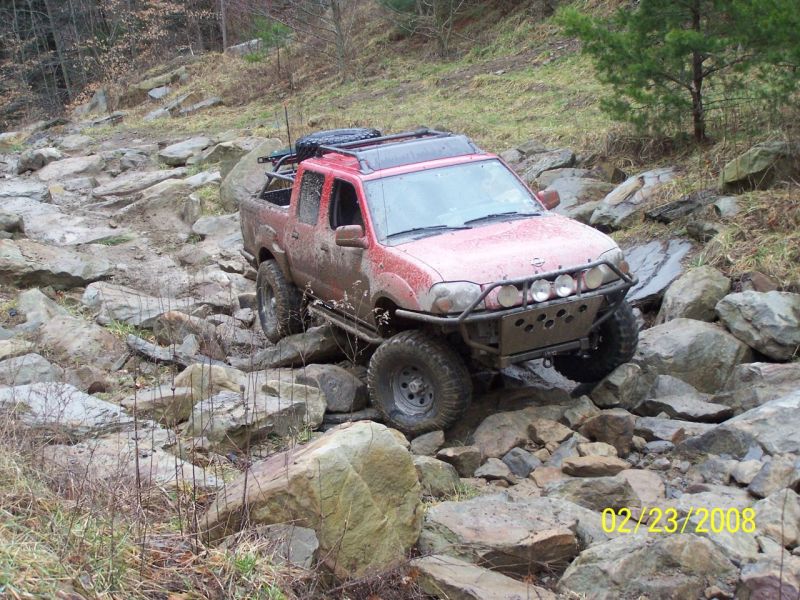

Last weekend my friend Brian came down and we put one tons under his previously IFS truck. He had beaten the thing up with the IFS and there wasn't much left to do.
Specs are
01 V6 Frontier
79 ford 60 front, 5.13s, open, GLO cover, hi angle toy flange
14 blt FF, 5.13s, detroit, disks, GLO cover, hi angle toy flange
4" toy springs up front with a leaf removed
Nissan aftermarket springs sprung over in the rear
14" 5150 bilsteins
37" xterrains on some aluminum wheels
24-25" under the frame
Its a little tall in front but has already began to settle down a bit, should a little more over time.
