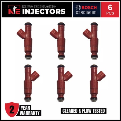

I bought mine from New England Injectors on ebay 6-7 years ago. 12 hole upgrade; zero issues and runs much smoother at idle and low rpm. I recommend!

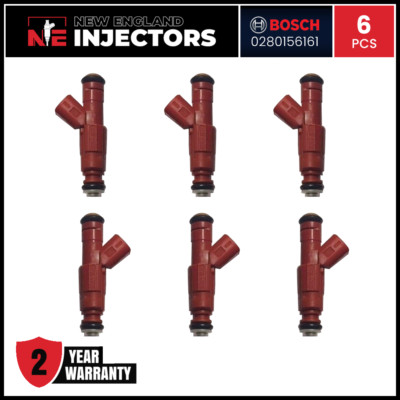

Hell yeah Thanks man that's what i wanted to hear going to order them this evening. That was something else i was waffling about was 12 hole or not. Also does anyone know where i could get dash plastic Its a 2001 cherokee sport if that matters i haven't really looked online yet more concerned with mechanical as of now.
Just take your time with install, clean fuel rail and bores where injectors go in well. Keep everything clean and use oring grease (silicone grease) on your orings; it isn't a bad job.
Someone will chime in, but if you go with 12hole injectors, I think you will need EV6 to EV1 plug adapters. If you upgrade to 4 hole (often called Neon injectors) you will not need those adapters.
I have run both, and I see a huge change in the butt dyno or the mpg, but the engine did feel a bit faster to respond and had a slightly smoother idle.
