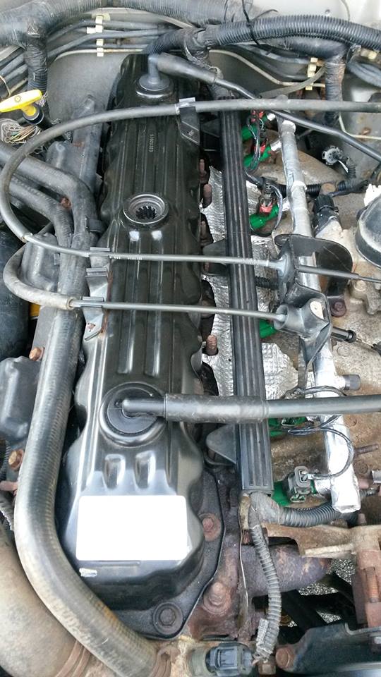

Usually this tech tip is for 3# cyl but its possible that the fuel rail is heat soaked (Hot Soak) boiling the fuel before hand. Do you run hot under the hood and do you have the EC Heat Shield over the exhaust header? Just a thought. I went with new injectors from Precision Auto Injectors and it took care of #1 and #3 misfires and smoothed the idle out. I also wrapped my fuel rail with heat tape.
