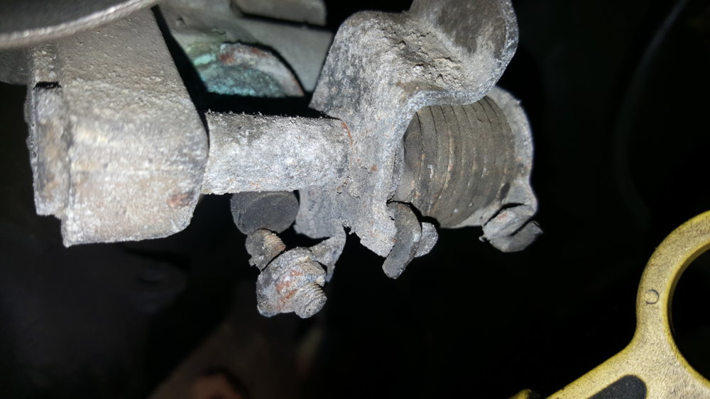

Is this the IACV?
no and you don't wanna know where it is either. Damn nips! It's under the plenum on the driver side...
