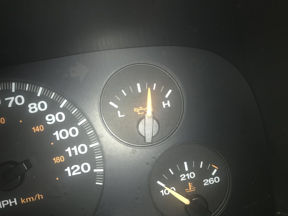

Daughter's 4.0 only made it 1/2 mile up the road this morning before gauges light came on. It leaks some oil so I thought maybe I was overdue in changing it. Changed it this evening and it is still reading zero. After I changed the oil it bumped up for about 1 second and then back to zero. It's pegged left and doesn't move at all. Before this it read straight up at idle and a little high when driving.

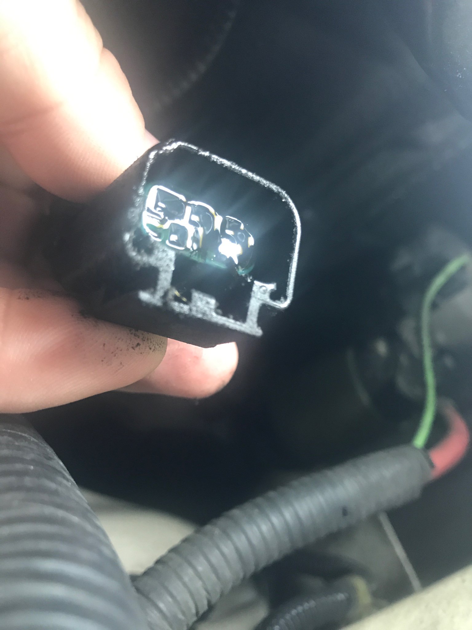

Oil in the connector. Diaphragm must be blown.

When I pulled the connector I heard a little pressure relief noise so I figured that was the problem. Oil is all over the connecter and the inside of the sending unit connections. Not to hard to get to unlike a crank sensor. Hope to have one in it tomorrow if I can find a good one locally.
Yahtzee!
