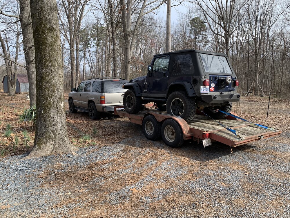

So there’s been very intermittent issues with a slight hesitation in the transmission of my wife’s TJ, I believe between 3rd and 4th gear. However it’s never been frequent enough for me to worry…..but tonight my wife is driving home from work and calls me saying it won’t go over 20mph and it’s making a whining noise.
So I have her pull into a grocery store and meet up with her, I drive it around and parking lot and notice the noise, it almost sounds like a bad steering pump, but since it was late I didn’t take it out on the busy highway she was off of to test the transmission. I’m gonna take the trailer and pick it up in the morning…..with this limited data, am I looking at a possible transmission problem here?
Also worth mentioning, I did check the fluid level, it seemed fine but I’m going to check it again once I get it home tomorrow

Just got it home so I’ll start digging to find out. Also, there’s no indication of overdrive being turned on/off when I hit the button for it
