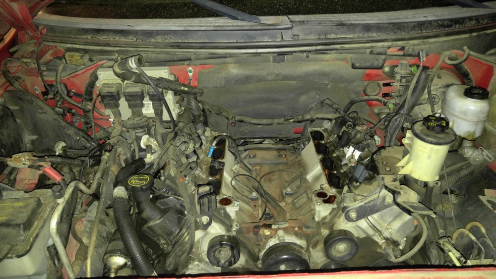

5.4 has a broken plug. How bad is it to pull the head? Is there a chance the head is junk?

As far a removing the head the worst part would be removing the intake manifold. They have a stupid vacuum hose on the back of the manifold that is terrible to get access too along with some actuator arms for something.
Can see the metal tube the hose hooks to on back of drivers head.
