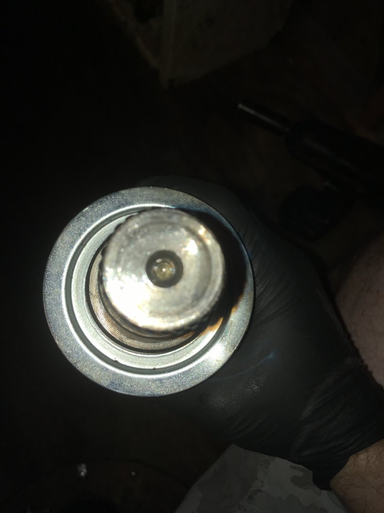

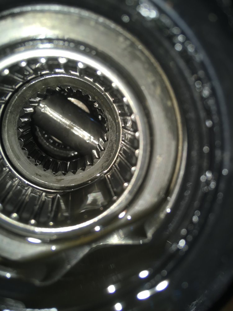

After reading lee's post about the clam bearing I checked the drives side shaft and it has some play in it, not sure if it's bad or not and I can't up load the video on here For some reason, But I will try to get the video uploaded somewhere . But the noise and vibration doesn't go away in 4wd it gets worse.
I'm no Toyota guy, but that definitely looks bad to me. I could see that making some noise for sure!
Just got around to fooling with the tundra . So I have some pix and a video to post , pix will come then the video when I get it up loaded. I have a local guy who is convinced it's the aftermarket cv, but nothing shows wear.

Ordered the reverse clam bushing and puller from east coast gear , they hooked me up on the price . So we will see if that fixes it.

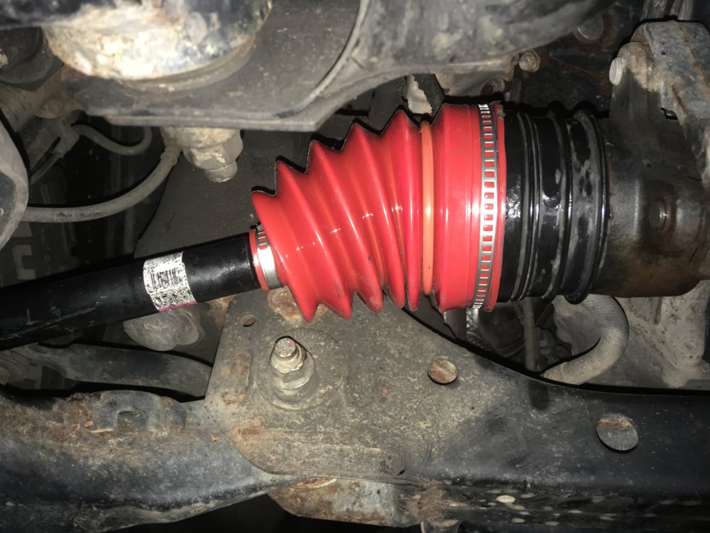

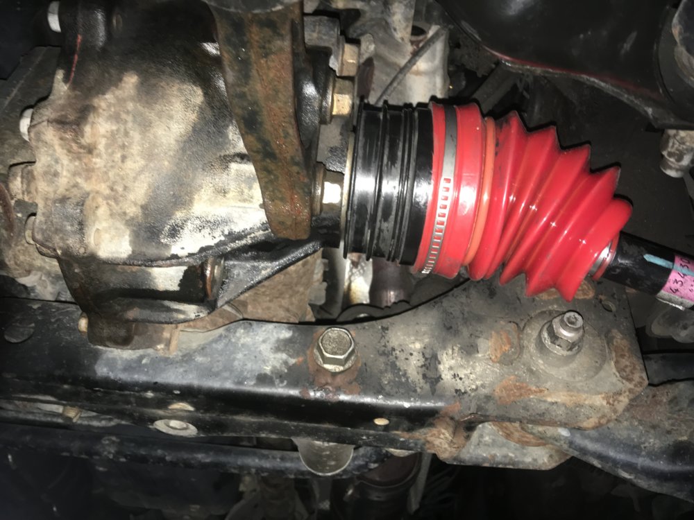

New high angle boots from Offroad solutions on factory factory toyota axles, all problems fix it's like we again.

I normally won't install boots but that is excellent for the application, though I wonder how close to the angular limits of the joints you are.
