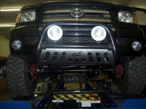

05 TUNDRA
Symptoms: Bad CV Boots, Stacked Lift Kits
Diagnosis- Needs D60
Specs:
High Pinion Dana 60- 4.10 Gears fresh bearings, Diff Bearings, wheel Bearings, Fresh King pin rebuild
6 Lug Hubs
Tundra Calipers, and Rotors
Radius arms- 2.5 DOM- .25 Wall
2.63" Joints and Bushings
Fox 2.0 12'' Remote Resevoir Coilovers
New Toyota IFS Steering Box
Chevy 1 Ton Tie Rod and drag link ends- 1.25 Tube - .25 Wall
We will add some more detail but this is the jist of it. Thanks to Olivers for hooking up the driveshaft. Thanks To Carolina Trugies for the Joints, and Coilovers. 4wheel parts for their alignment specialties and RTI Ramp. No thanks to ballistic we waited 22 days for the radius arm/coilover mounts. Good product but I could have shaped them from solid stock and a hand file in 22 days.

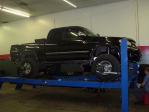

VERY NICE!!!! What size tires is this guy running also what rear axle???
SHE is running 35's Stock 8.4 rear axle but its ready for a 14 bolt. V8 Engine totes it around pretty good. depending on useage the 8.4 will live for quiet a while.

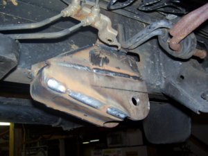

radius arms are .375" wall. i cant give away all my secrets but here are some other pictures i hid from chase.

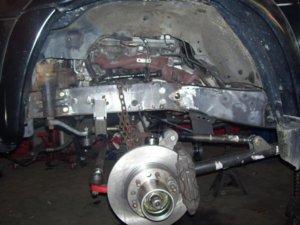

tundra brake setup, we did this because the "other guys" 6 lug brake setups are really chintzy and use the small metric chevy calipers and rotors. this way any monkey can install factory rotors and pads when its time for a brake job.

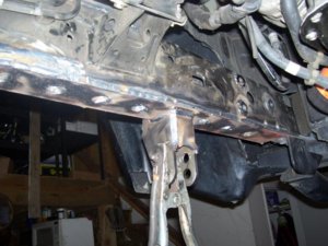

steering box frame sleeving and frame plating

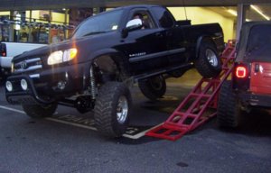

steering shaft firewall plate. as you can see the steering shaft used to point straight down and it needed to point forward
