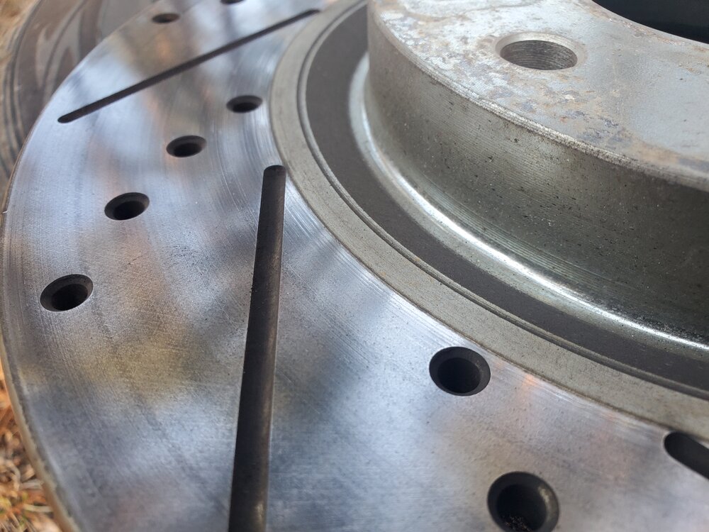

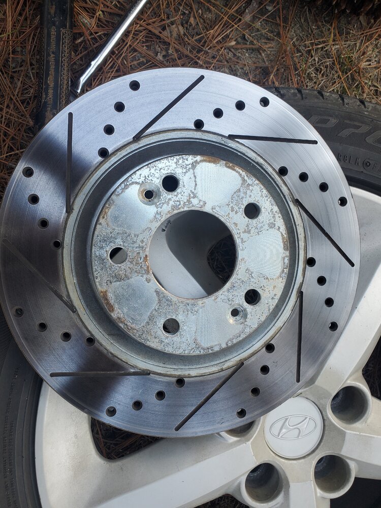

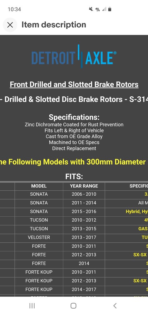

About 6 months ago the car was shaking bad and getting worse fast. I replaced the front calipers and rotors with detroit axle drilled and slotted rotors for $95 a pair. I reused the pads.
That fixed the shaking issue completely from what I remember.

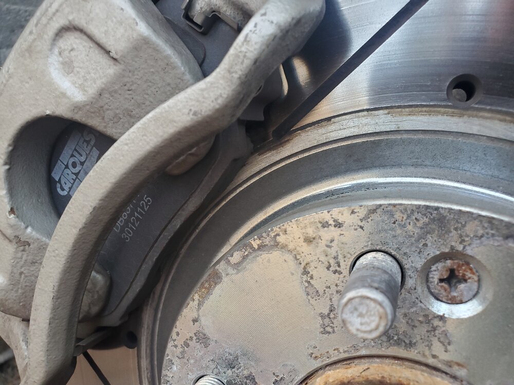

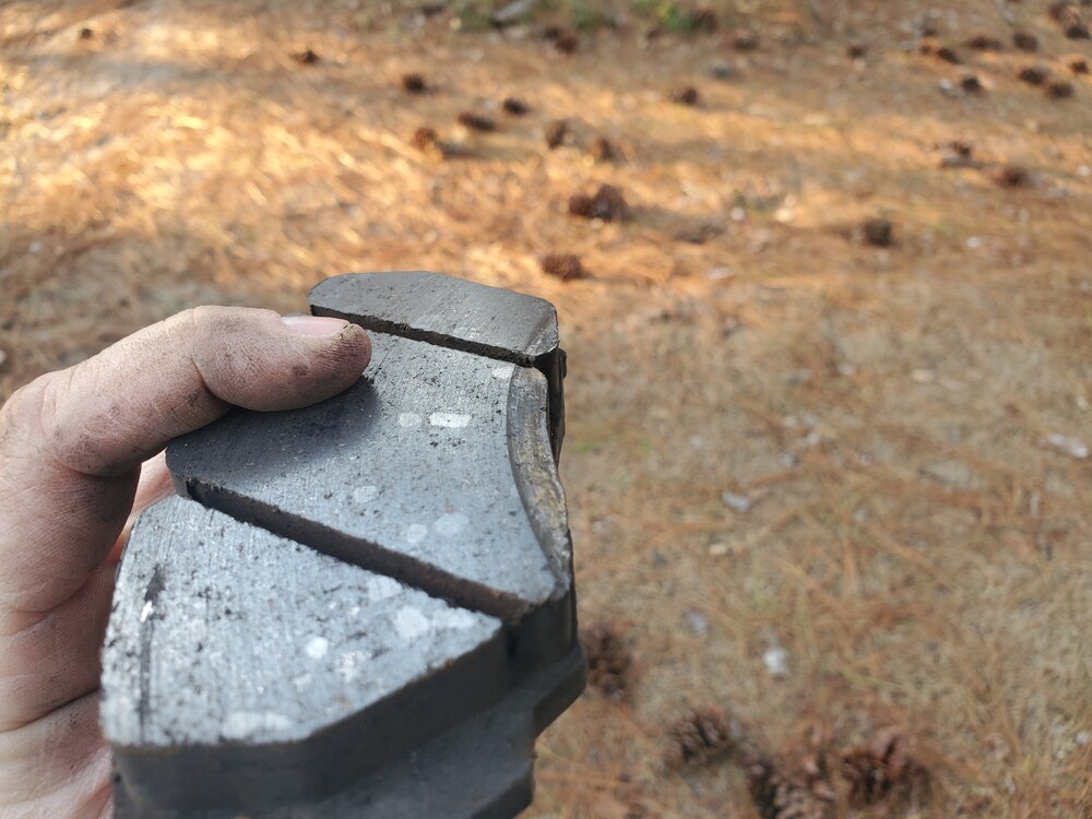

About 3 months ago I started noticing a slight vibration again when braking but only when I first start applying the brake and this time the steering wheel didn't shake. I assumed it was the rear rotors and replaced them with drilled, slotted rotors. I replaced the pads too. That made no difference in my vibration issue.
The car still vibrates in the pedal and floor when I start applying the brake and it is slowly getting worse. It is only noticable when starting to brake at 45 mph+. If I apply the brakes hard the vibration goes away.
