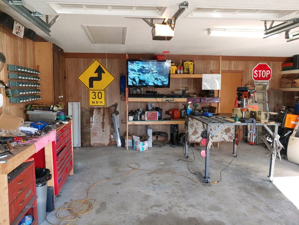

And since threads are useless without pictures, here is the shop prepped for work and streaming next week

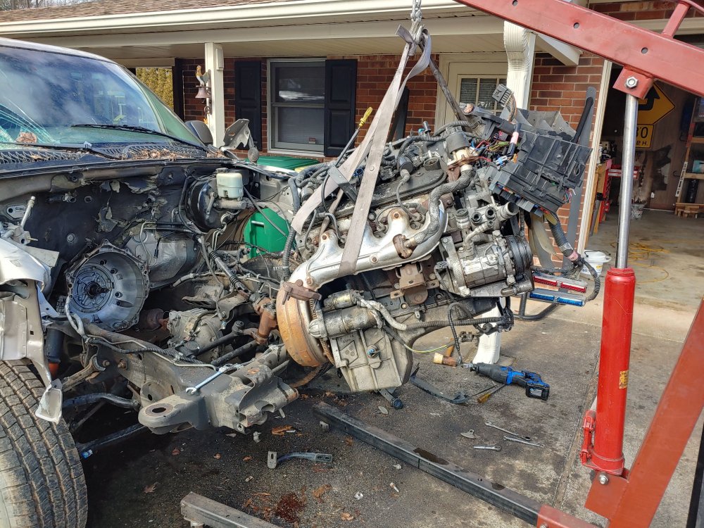

Another weekend of some decent progress. @Falko (thanks again for the help) came over Friday and Saturday. Between watching Hammers and drinking more than a few beverages we were able to get the front degree shims installed and square up the leaf spring hangers (the FUSH kit from ORD requires spacers I had previously installed incorrectly), finish drilling holes and mounting the rear shackle hangers, and pull the 5.3 from the yukon and get it loaded on the trailer.

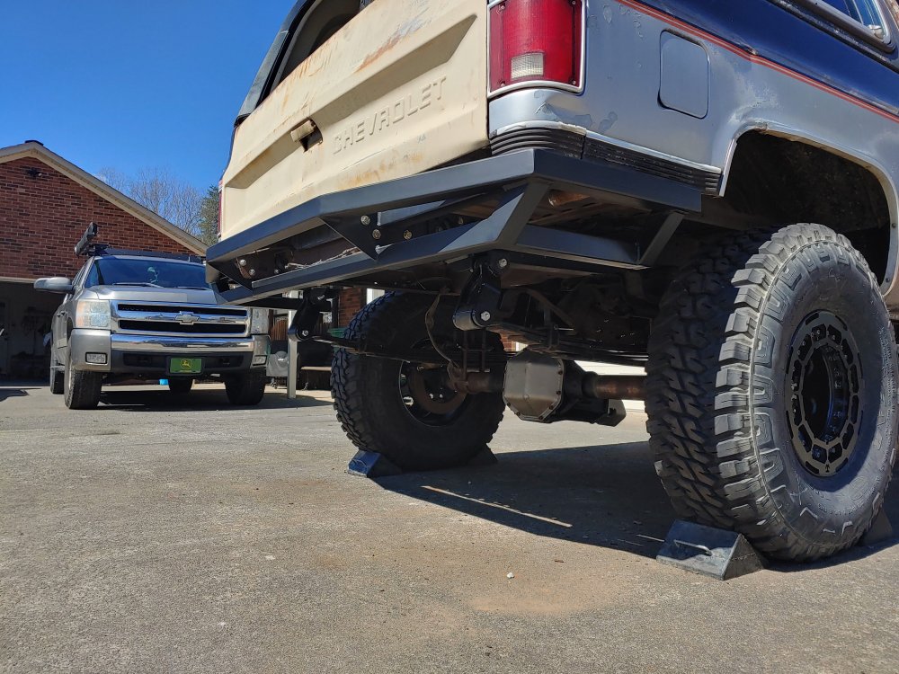

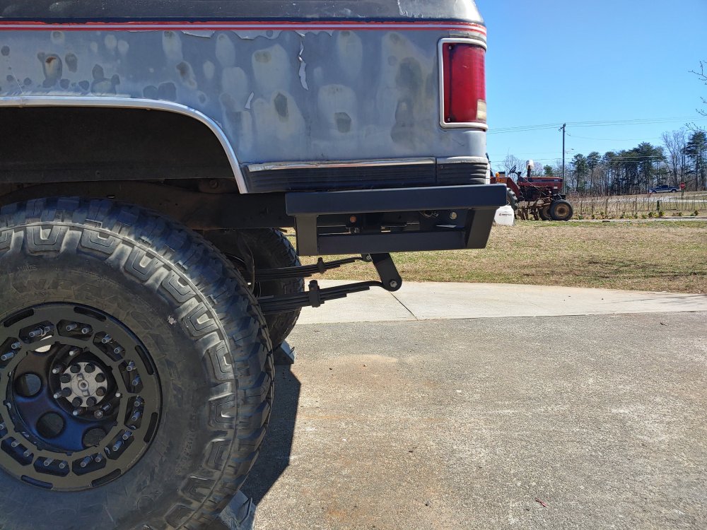

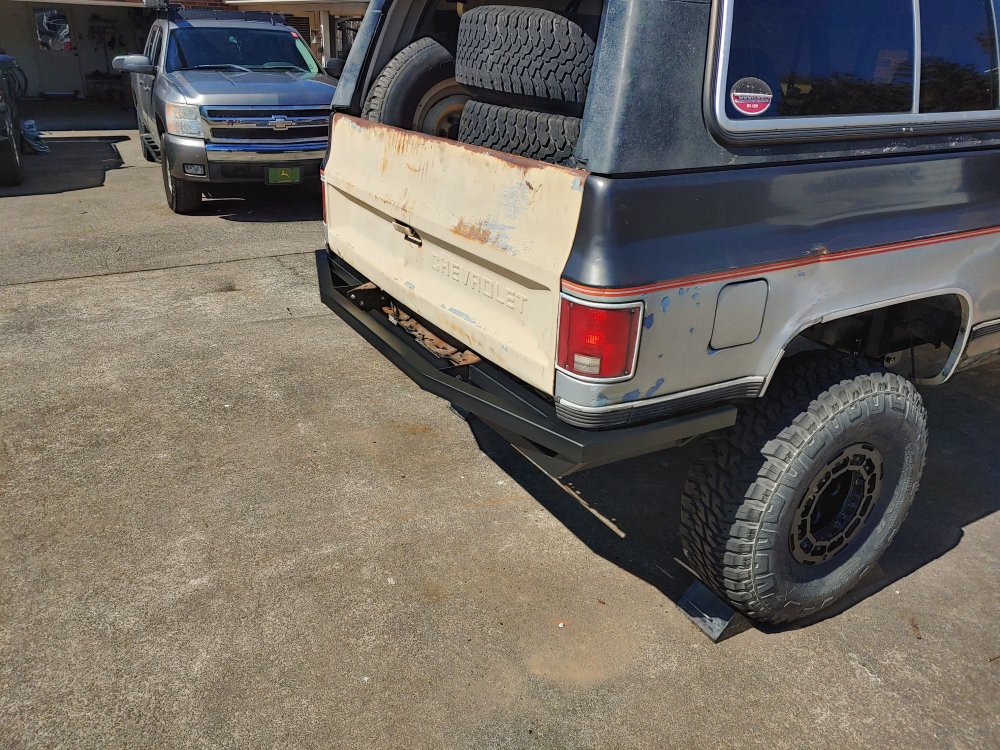

Spent most of Saturday out in the shop and knocked out the rear bumper. Still need to figure out where to mount the license plate and make a filler panel for the top center section. Going to make a bolt in brace from the frame to the sides as well.

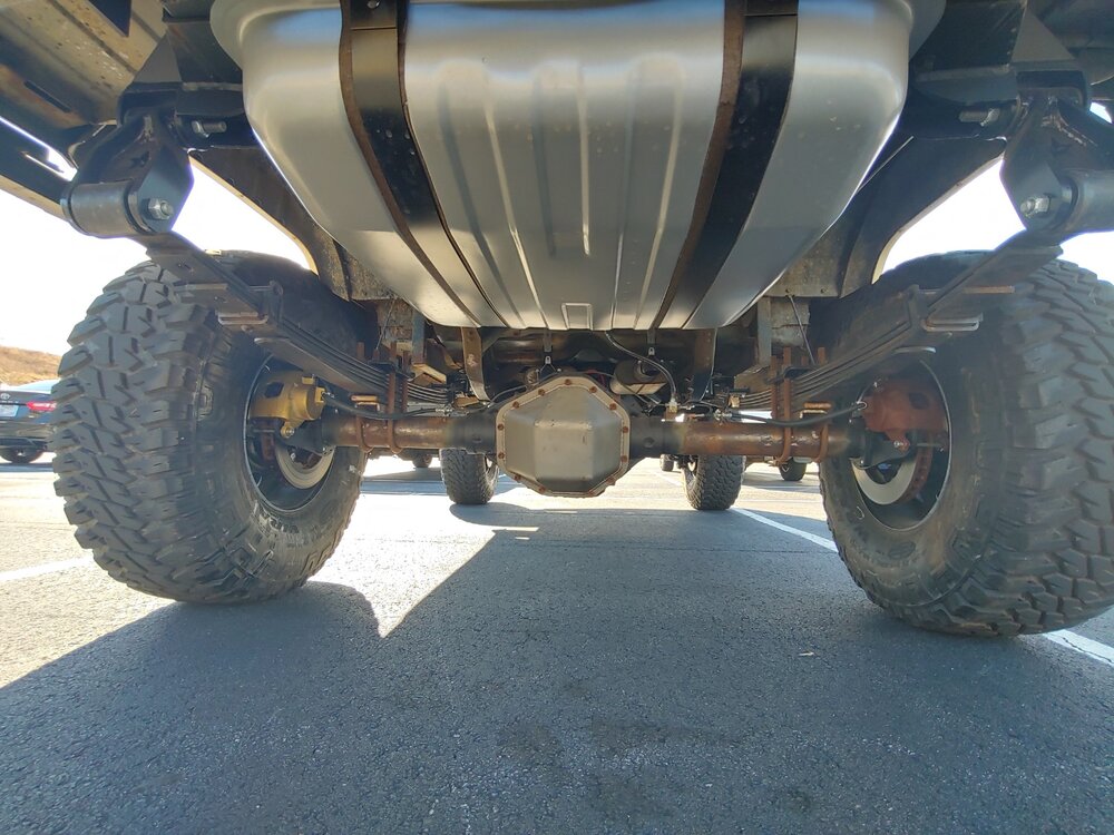

More progress lately. All new fuel tank, pump and sending unit are in. New filter and lines that far up as well.

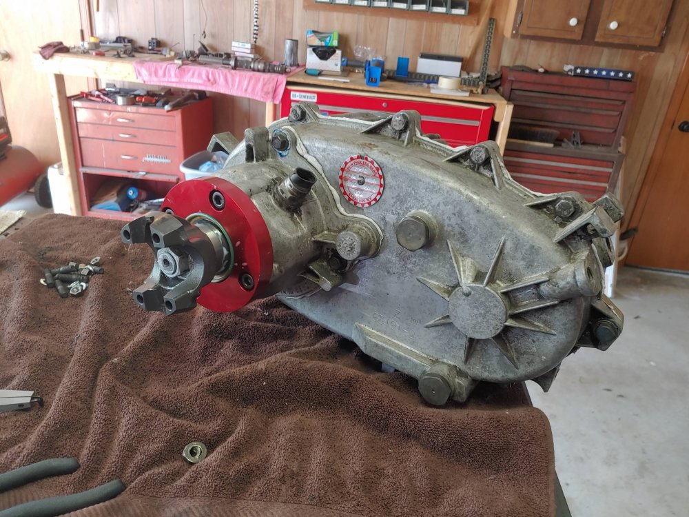

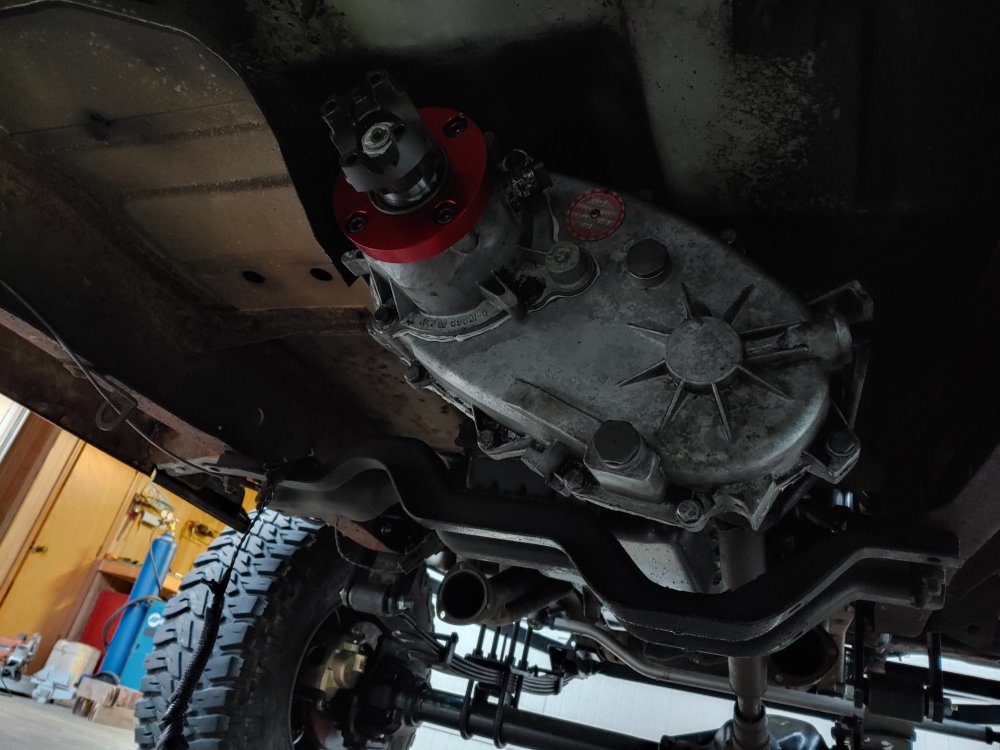

Cleaned up the 241 and got the SYE kit form JB Conversions and clocking ring from ORD on as well.

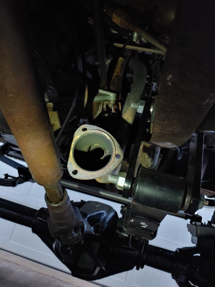

Been slowly knocking out all the little stuff as I can. Checked that all the linkage still works and threw the stock front driveshaft in the check for clearance. I can almost get my finger between it and the collector at ride height so I have a set of center dump block huggers on the way to address that. Need to get some material to make a new crossmember/ skid mount. If I use 1.5in material I will just need a small 1in bump under the t-case front output so fairly flat belly without any need to chop up the floor. Exhaust doesn't look like it will be too complicated either.

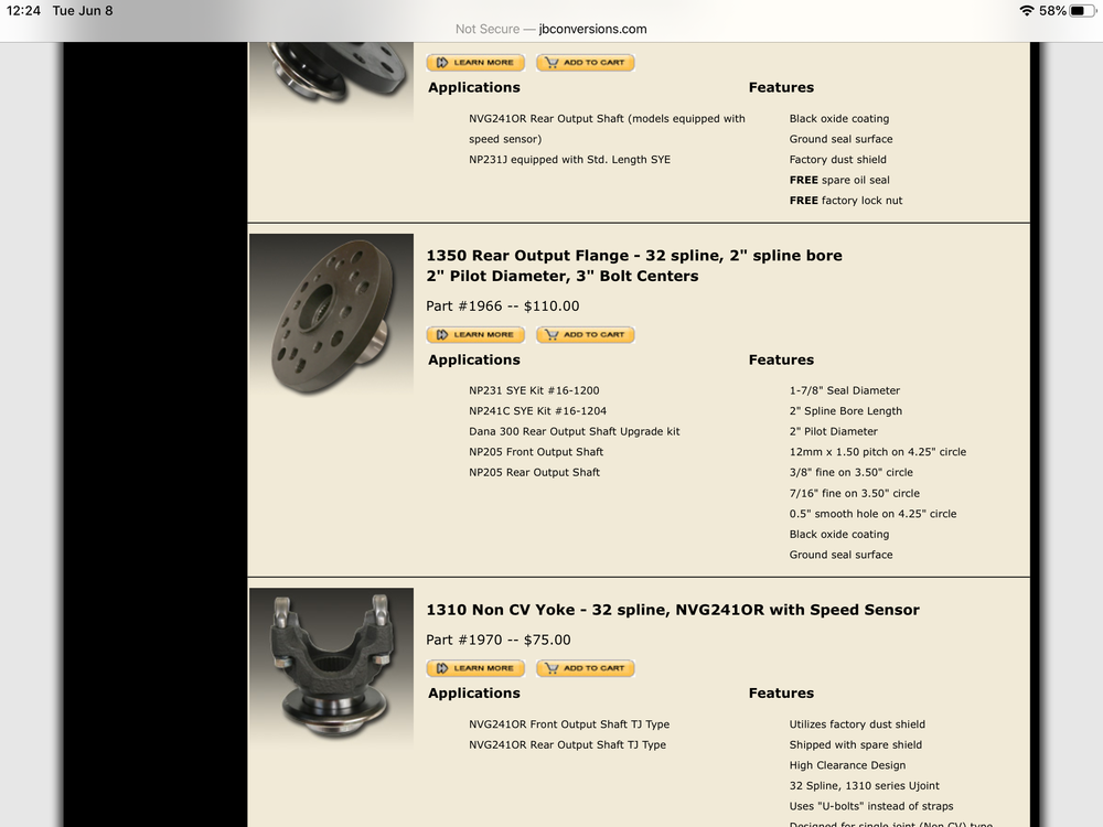

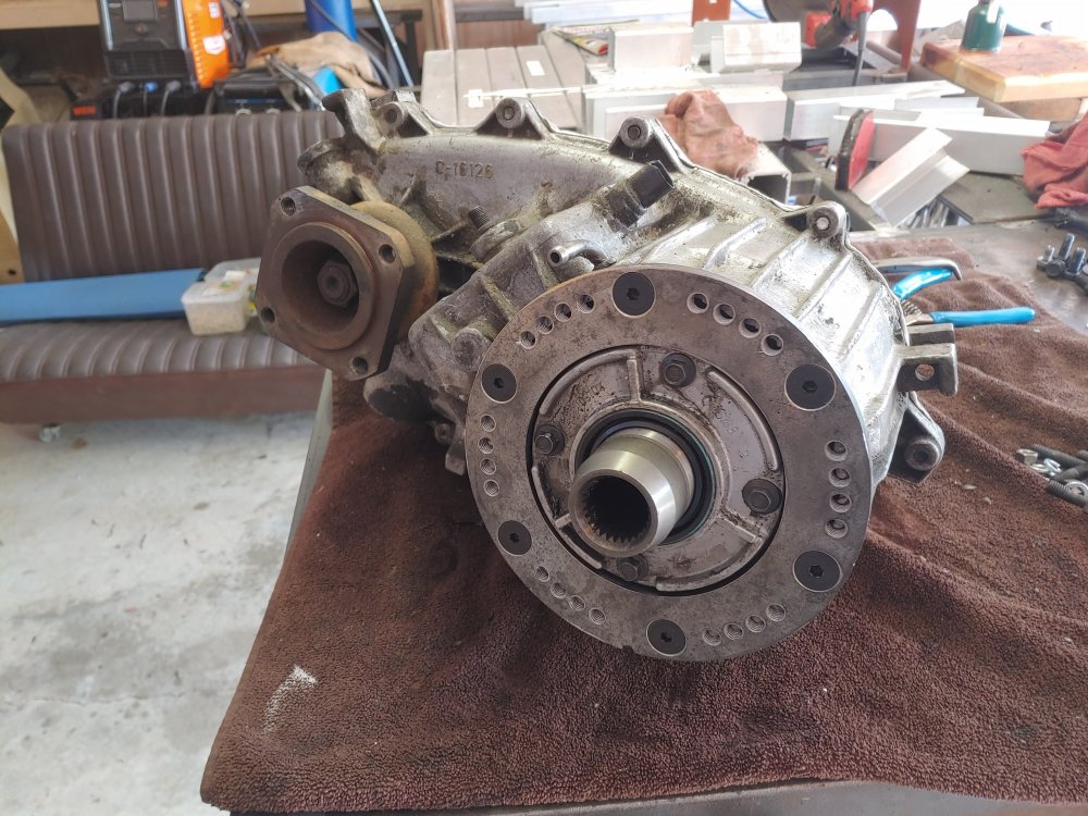

Those outputs fit an NP205 yoke if you shorten it up some and get the correct seal. I'm running a 1410 rear on the one in my 99 Silverado so my whole shaft is 1410 joints.
Will be fun to see this one come alive again! I am actually just down the road a bit, Kvegas address but I can see Walkertown from my front yard, I am near Old Valley School Rd / Old Hollow Rd! Also a K5 guy, mine is a Red 88 with tube doors and soft top on the rear.
What length rear shaft do you need? I’m running an ebay special $180 1350 CV style one, it’s originally an f250 front driveshaft. 36-41” long. Depending on the slip yoke you use you can make it longer.
It measured out to be 37 inches, currently has a 1310 CV yoke on the tcase that came with it from JB Conversions. Not sure how changing to a flange would impact that measurement. I am honestly more worried about travel. I'm currently pulling just over 14 inches of vertical travel and haven't even maxed it out. Will definitely need to be bumped and strapped based on either u joint angles or what shocks I can package under there. If I can use a stock unit that would be nice though.
Oh crap disregard my PM that was for the front shaft. For the rear you need to measure the yoke OD of the seal surface and see if it matches a 205 seal ID. I know the 241 has a 32 spline output.

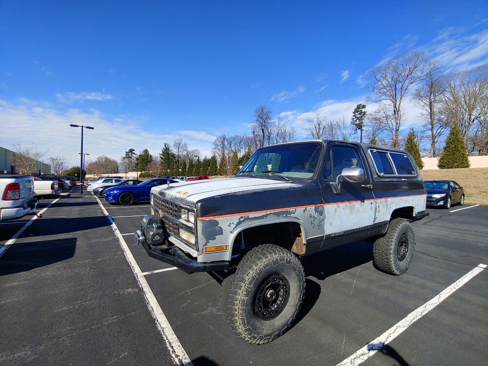

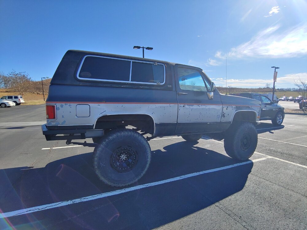

Time to revive this thread. Finally got the K5 back on the road this week.

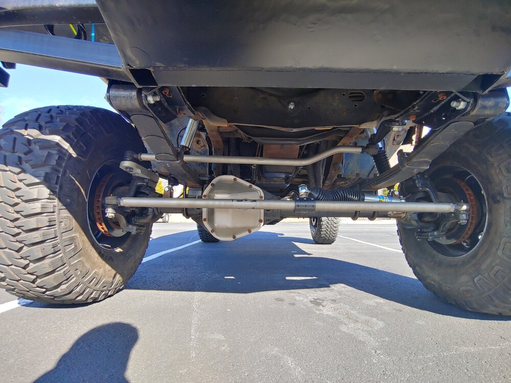

Not much for pictures along the way but I got tired of it sitting in the same spot and decided to just get it going again. I ended up pulling the clocking ring off and throwing the old exhaust back on it to get it on the road. I had Olivers in Winston build me a new rear DS, put in a new Optima red top, checked all the fluids, bled the brakes and went for a drive.

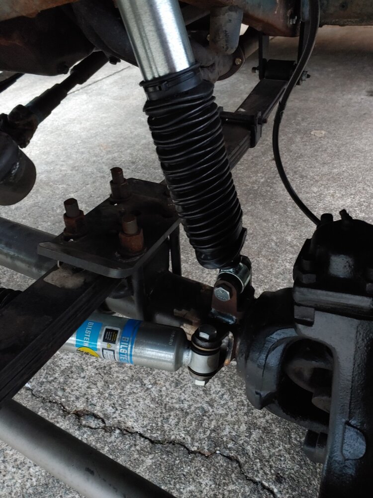

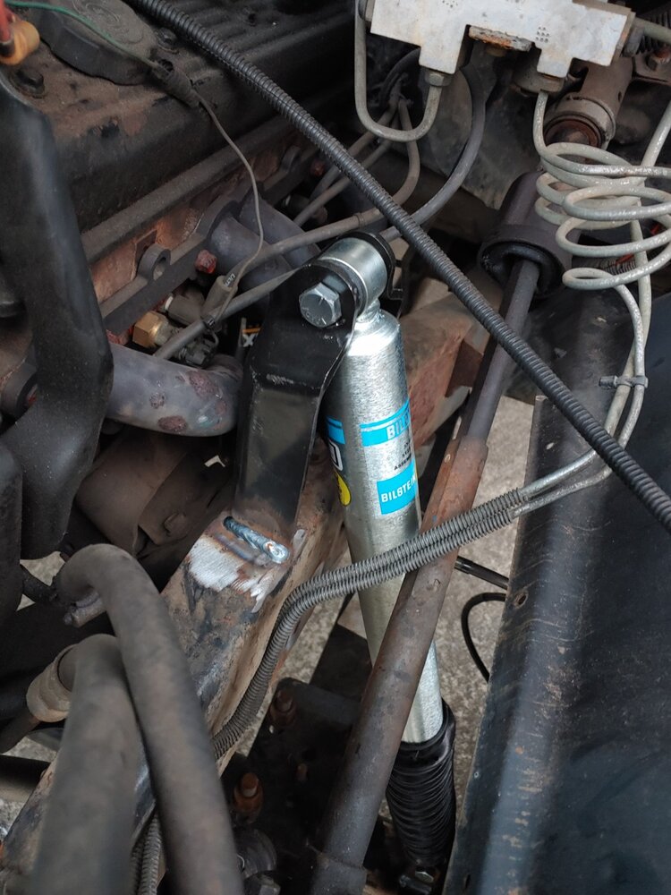

I quickly realized that the leafs alone were not going to cut it and out of round 37s on home re-centered H1s were going to need a steering stabilizer. Front shocks and some parts from Barnes helped an enormous amount and I have been driving it to work all week.
So far only issues are a small leak in a rusted brake line (I will replacing that this weekend) and the rear end is super soft so getting those shocks mounted are next.
On to the pictures!
