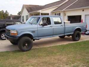

This is mine long and heavy....get rid of backseat and have short bed if offroading
95 F350 beast
5 speed manual
7.3 turbo
D60 frt
205 tc
The 33in tires will fit perfect
Also you can get these trucks with a 460ci
